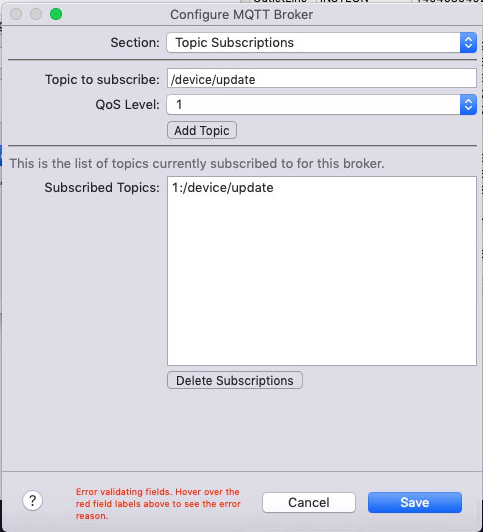

@FlyingDiver
I just tried version 0.0.7 but something is amiss.
- Screen Shot 2019-08-08 at 10.30.42 PM.png (107.41 KiB) Viewed 1628 times

Re: Subscription options
You should post the log output. But I suspect it's this one: viewtopic.php?f=316&t=22761#p180396mreyn2005 wrote:@FlyingDiver
- Posts: 7830
Release 0.0.8 posted with fix.
https://github.com/FlyingDiver/Indigo-M ... /tag/0.0.8
Yup that looks like it. Sorry for posting in the wrong room.
