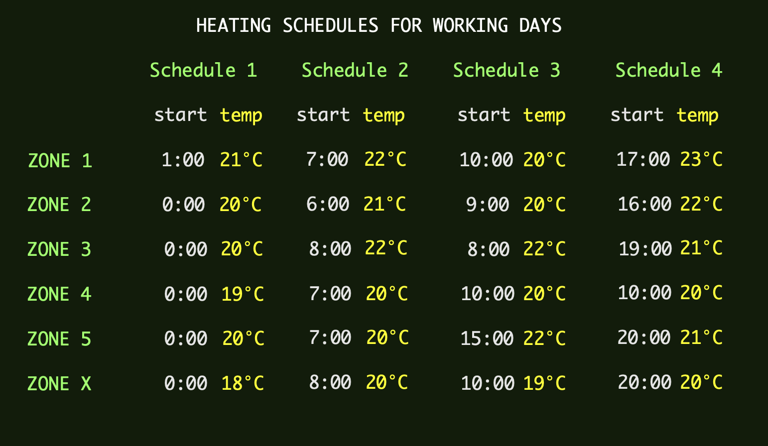

Currently at my house I have a few schedules predefined using standard Indigo app. I like the idea presented by autologous but I'm still missing something ;-)
I would prefer to have a possibility to define them much easier. I wonder if it would be possible to create a Control Pages as attached below to set up schedules so that anyone could understand and define easily. I would need a separate Page for "working days", "weekend", "holiday" and maybe one for "out for a dinner" :roll: etc
A ZONE may consist of a few radiator thermostats or other heating devices (electric heater etc) Each schedule would start after the previous one so there shouldn't be a need for a start/end times.
What do you think?

That's a nice idea :)
Your schedules are running contiguously without any breaks in-between. The TRV plugin allows for breaks in-between the schedules. I do like the idea of just specifying times and set-points and if it was increased to nine schedules, that would enable one to do what the TRV plugin currently does.
I also like the idea of defining zones and then assigning heating devices and thermostats to the zone. :)
However, I don't think the current Indigo Control Page design lends itself to this type of layout in respect of being able to alter the contents. It's not impossible but I think would mean tapping / clicking on a field and then going to a separate form to modify it. There would need to be a whole series of actions to be able to support it. Not impossible, but not simple to do.
