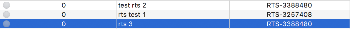

 WebServer                       request to turn off device "rts test 1" from 127.0.0.1
   RFPlayer Error                  Error in plugin execution ExecuteAction:
  File "plugin.py", line 314, in actionControlSensor
KeyError: (u'RTS-3257408',)
   WebServer                       request to turn off device "rts 3" from 127.0.0.1
KeyError: (u'RTS-3388480',)
Skærmbillede 2018-07-29 kl. 17.39.28.png (37.37 KiB) Viewed 4714 times
Re: Somfy/RTS control
Your devices 2 and 3 have the same address. Which should never happen. I need to look at the code again.

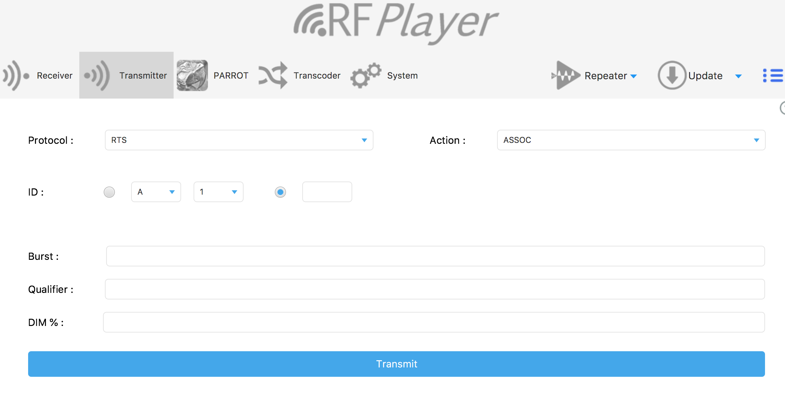

i have now discovered how I think the other examples I posted are doing it you need to
ASSOC them I got this to work in the rfplayer config.
1. you take the remote push the programming button on the bag the shutter jiggle
2. the in the RFplayer config you go to transmitter page send command thru RTS ASSOC the the shutter jiggle
3. push the programming button on the remote to stop the programmning mode
4. now I can transmit on/off in the transmitter on the rfplayer config.
5. and control them up/down
Skærmbillede 2018-07-29 kl. 18.30.46.png (207.58 KiB) Viewed 4706 times

   WebServer                       request to turn on device "new device 2" from 127.0.0.1
   WebServer                       request to turn off device "new device 2" from 127.0.0.1
   WebServer                       request to turn off device "new device 3" from 127.0.0.1
   WebServer                       request to turn on device "new device 3" from 127.0.0.1

FlyingDiver wrote:But it still doesn't work from Indigo, correct?
No it does not work even when I done the assoc from rfplayer config
But the two other controllers are doing assoc from there software
Skærmbillede 2018-08-01 kl. 20.28.28.png (301.09 KiB) Viewed 4654 times
koburg wrote: No it does not work even when I done the assoc from rfplayer config
It's the hardware you're associating, so it doesn't matter which software you use to do it. I just haven't put the commands to do an ASSOC in the plugin yet.
