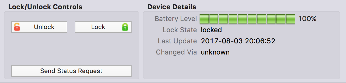

Re: Schlage BE469 Issues
Here are log excerpts.
Manual unlock and lock:
Indigo unlock and lock
I see "Changed Via unknown" in Indigo client UI for the actual z-wave lock. See attachment.
It looks to me like the Schlage lock just doesn't send a z-wave message when locked or unlocked via Indigo, which is a shame. It has been working reliably, but I do wish I could a) trigger off of un/lock by indigo events and b) set and clear the auto-relock feature. I realize these simply may not be possible for this unit, but I'd like to be sure before giving up.
Thanks so much.
Thanks so much.
