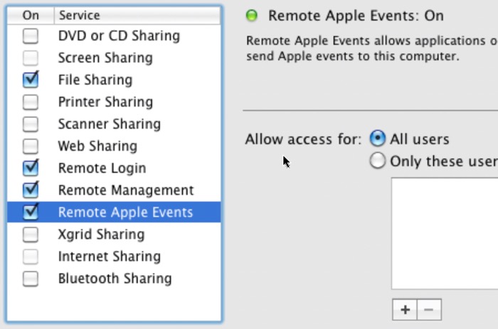

I have the destination machine setup to accept everything.
Pretty sure it’s confirmed in that the plugin works fine under 10.8.
I’ve attached a screen shot of the sharing settings for it.
Carl
Carl

It works on all versions of macOS, I've confirmed it.ckeyes888 wrote:Pretty sure it’s confirmed in that the plugin works fine under 10.8.
Does your password have any special characters in it such as backslashes or quotes? Is there a firewall running on the destination? There aren't many things that can prevent this from working, I have dozens of these devices talking to a number of different computers with no issues.
