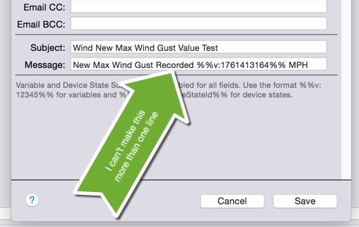

Hi Joe, I just installed your Better Email plug-in and it is working great for me. I tested it by sending myself an email that includes a message that contains variable information. It works but I can't get the plug-in message field to enlarge. I would like to add much more detailed information into the message but it will be hard with only one line showing. I can keep typing (the field will scroll) but it is hard to manage for a long message. This may not be a limitation of your plug-in since I have seen this elsewhere but asking because you may have seen it and have a solution (plus I wanted to say thanks for providing the plug-in).
Picture below which may help illustrate what I'm talking about.

- Posts: 7830
Re: Better Email plugin discussion thread
Indigo doesn't currently have a way to do a multi-line field in the device UI dialogs. See : http://forums.indigodomo.com/viewtopic.php?f=18&t=8338
Easiest way to do what you want, at this time, is to create your message text in a plain text editor, then paste it into that field. Not practical to edit it there, but you can at least get it in there.
If this is something that comes up a lot, I could probably add a way to specify a text file path for the message body.
