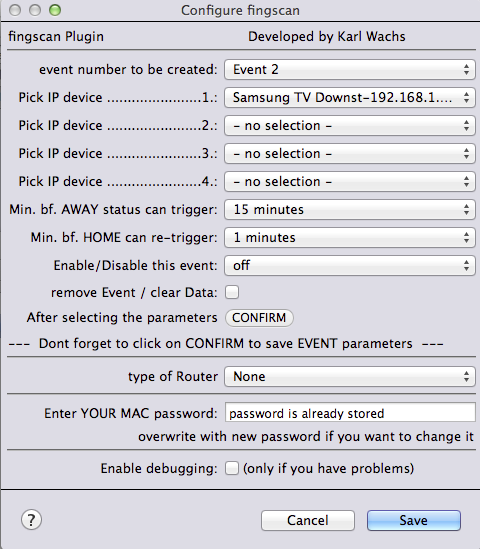

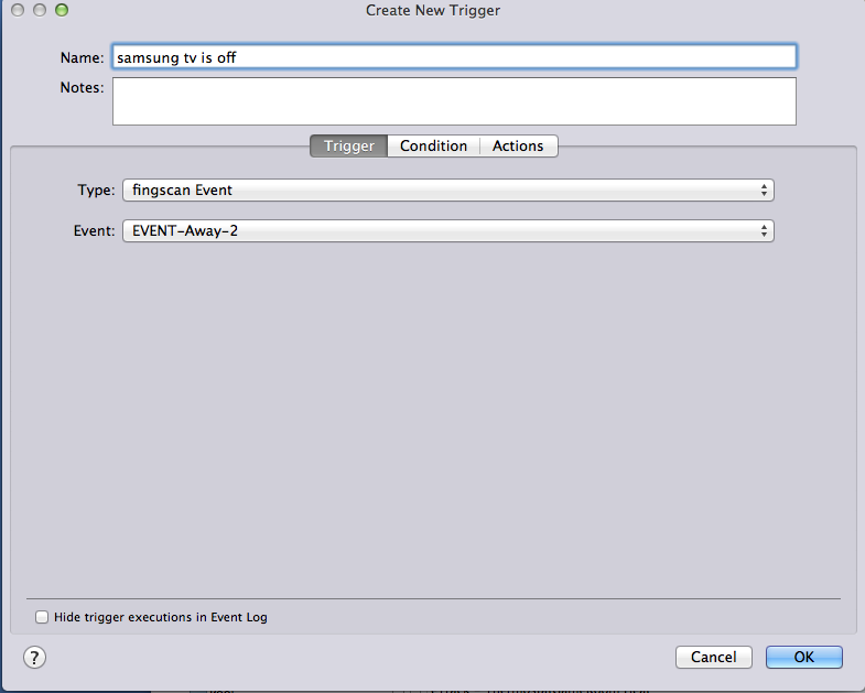

My Nest occasionally (once or twice a week, or sometimes not for a couple or three weeks) will drop off the wifi network. Sometimes I won't notice that it's gone offline for 20 hours or more. (And yes, I've gone through all of Nest's troubleshooting recommendations and also contacted support, but the stupid thermostat simply won't connect to the wifi network that it was previously connected to without me telling it to do so by hand. Dumb programming, Nest.)
I'd like to create a trigger that would send me a notification (email/sms/voice) when the thermostat couldn't be communicated with, but I can't find anything in this plugin that will trigger such a trigger. Am I missing something simple?
Re: New NEST Plugin ready for general use
Alphaman: try FINGSCAN... you can setup a trigger for any IP device(home or away condition).
for your situation:
Setup an "away" EVENT#2 (in this screen shot example) in FINGSCAN/plugin/config for the NEST device, use timeout ~ 15 minutes to avoid false positives.. see attached image for a configuration for my SamsungTV (make sure event is enabled , in the screen shot its OFF)
I get an away event if its down for more than 15 minutes.
Then setup a trigger on a FINGSCAN event and pick AWAY-EVENT# 2 (in this example), and as action do an email etc. see other screen shot.

for your situation:
