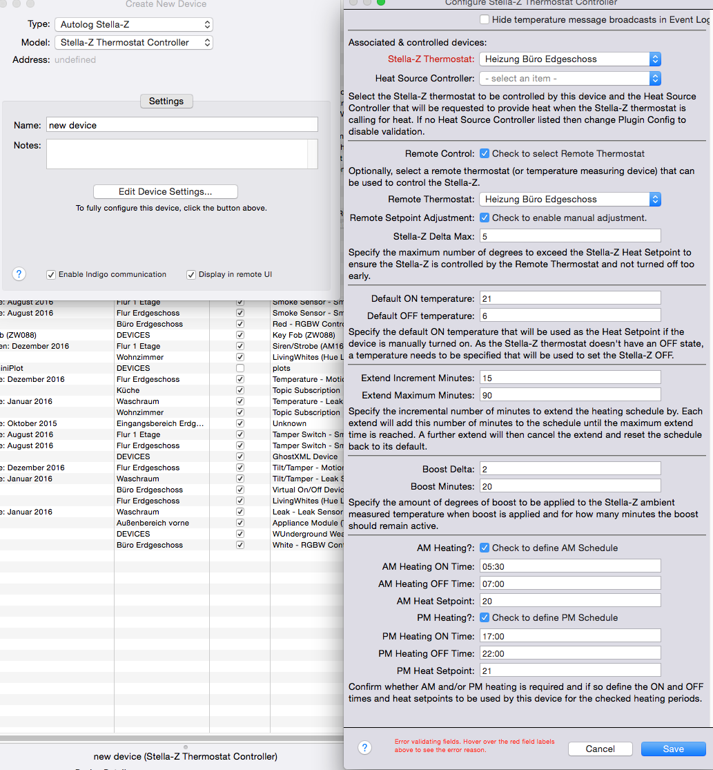

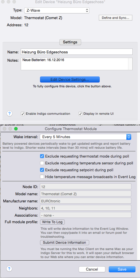

Jon,
I have now the Comet radiator thermostats and already make the first mistake...
I've included the first one as a "standard Indigo thermostat" and after that installed your plugin...
Should I delete it and create a new device as a Stella-Z device?
Another question about the lime protection: our heating is not provided by a boiler or so. It's a heating system with runs 24/7 (well it tuns off heating by night and turn on in the morning, it has a mechanical setup)
So I can't select in the plugin the "Heat Source Controller".
Does that means the lime protection will run? If yes, where can I select the schedule? Do I have to create one first??? Where are the "Autolog actions"? Can't find them.
Don't realize this points here, sorry.
Yassi
UPDATE: Seems so, it doesn't recognize the Comet somehow, or am I doing something wrong? See screenshots.
Bildschirmfoto 2016-12-16 um 20.07.58.png (139.43 KiB) Viewed 4322 times
Bildschirmfoto 2016-12-16 um 20.07.08.png (396.41 KiB) Viewed 4322 times
