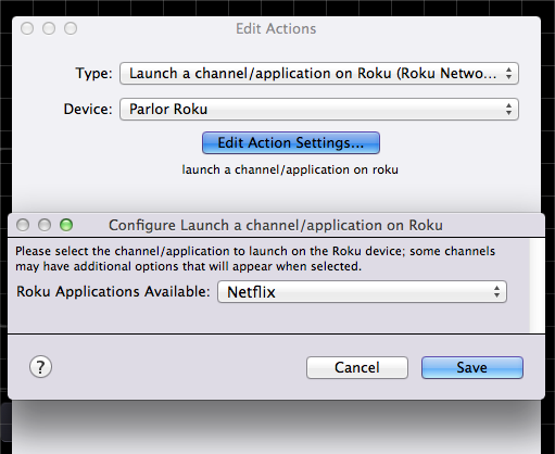

Hi Dave - good deal. We're getting there. Here is an example of one action that I use to launch the Netflix channel:
Screen Shot 2015-11-25 at 1.44.52 PM.png (53.88 KiB) Viewed 5602 times

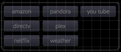

It's tied to a static image of a button. I have several defined in the same way. Note that the direcTV button actually changes the source on my DVR to show my direcTV feed after watching the Roku.

I think Dave answered the channel launching... mine does exactly as his is setup to launch channels. In terms of downloading channel icons, it won't do anything that you can "see", just that the icons for the channel will be downloaded into the images directory in your Indigo directory structure (in the 'static' subfolder IIRC).
