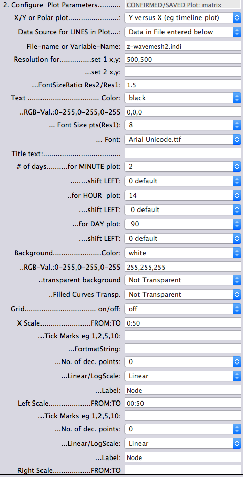

richo,
the attached plot is done using the attached code to convert YOUR file to x;y format
import os, pwd
dirPath= '/users/'+pwd.getpwuid( os.getuid() )[ 0 ]+'/documents/indigoplotd/data/'
inFile= "z-wavemesh.csv"
outFile= "z-wavemesh2.indi"
g=open(dirPath+outFile,"w")
f=open(dirPath+inFile,"r")
g.write("#;dots\n")
for line in f.readlines():
	line = line.strip("\n")
	line = line.strip("\r")
	parts =line.split(";")
	if parts[0]==""  :continue
	if parts[0]==" " :continue
	print ">>"+str(parts)+"<<"
	for k in range(1,len(parts)):
		if len(parts[k]) ==0  :continue
		if parts[k]==""  :continue
		if parts[k]==" " :continue
		g.write(parts[0]+";"+parts[k].strip("\n")+"\n")
f.close()
g.close()
#x;dot
3;7
3;8
3;9
3;10
3;11
3;14
3;19
3;21
3;24
3;29
3;30
3;31
3;32
3;34
3;35
3;58
3;101
7;3
and the settings shown in the screenshot
then select add line.. choose linetype = DOT*
Is this what you want?
naturally you could change colors could add grid lines ..

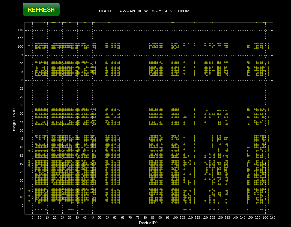

Wow, this is it :D
If you implement the other one that would be something extra. We are getting close to heat maps...
I start enjoying the Indigo community more and more. Very responsive and proactive.
Thanks a lot.
Here is a map of my z-wave mesh. Plenty of nodes so not very clear but want to add ability to choose devices to display to limit the number of dots.
PS
I wonder if there would be a possibility to suppress the nodes that don't have neighbors to remove the large gaps in the chart. Usually these are the nodes removed from the network.

Re: INDIGOplotD -- a plot tool for indigo
richo,
just a comment: your Y-scale excludes some nodes.. should be 0:165 like the x-axis
Do I understand your question correctly: you want to get rid of e.g. the nodes ~65..~82 .. just not draw them?
One way would be to remove them from the data you supply. In the program I supplied add an if statement something like if line empty continue (a little bit more complicated...)
or you sort the file then cut ..
The plot function will always plot the data you supply, don't know how to suppress data that is in the file..

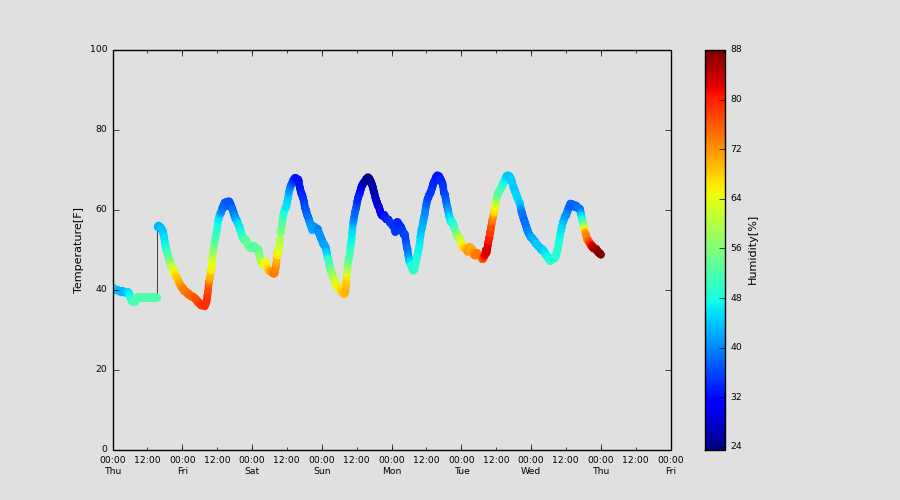

coming up: scatter plot with weight = color / size of circle / size of bubble..
This example shows temperature (left scale) and the point colors indicates the humidity at that point in time.

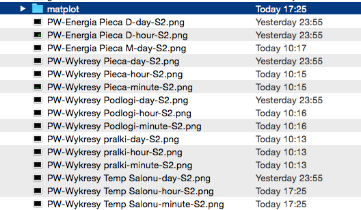

I don't know what has happened but PlotD has stopped to generate new charts for some of them.
I haven't changed anything and most of them stopped working yesterday before midnight.
During the day I have confirmed and updated a few of them but after some time they have stopped being updated again. One of them "Temp salon.." however is working w/o problems !?
SQL data is OK and plugin reload doesn't help at all.
See the attached image:
PS
Reloading SQL helped but don't know for how long.
Screen Shot 2015-01-22 at 17.25.15.png (104.97 KiB) Viewed 5080 times

richo wrote:I don't know what has happened but PlotD has stopped to generate new charts for some of them.
PS
Any entries in the log file?
could you send me:
1. menu select print/log plot info
2. menu select print/log device info
3. menu select print/log formatted data .. send ../data/minute.data.formatted
4. /matplot/matplot.log file (when you are using MATPLOT)
