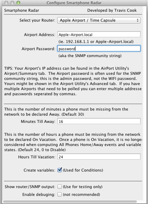

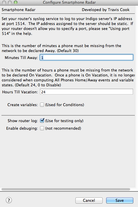

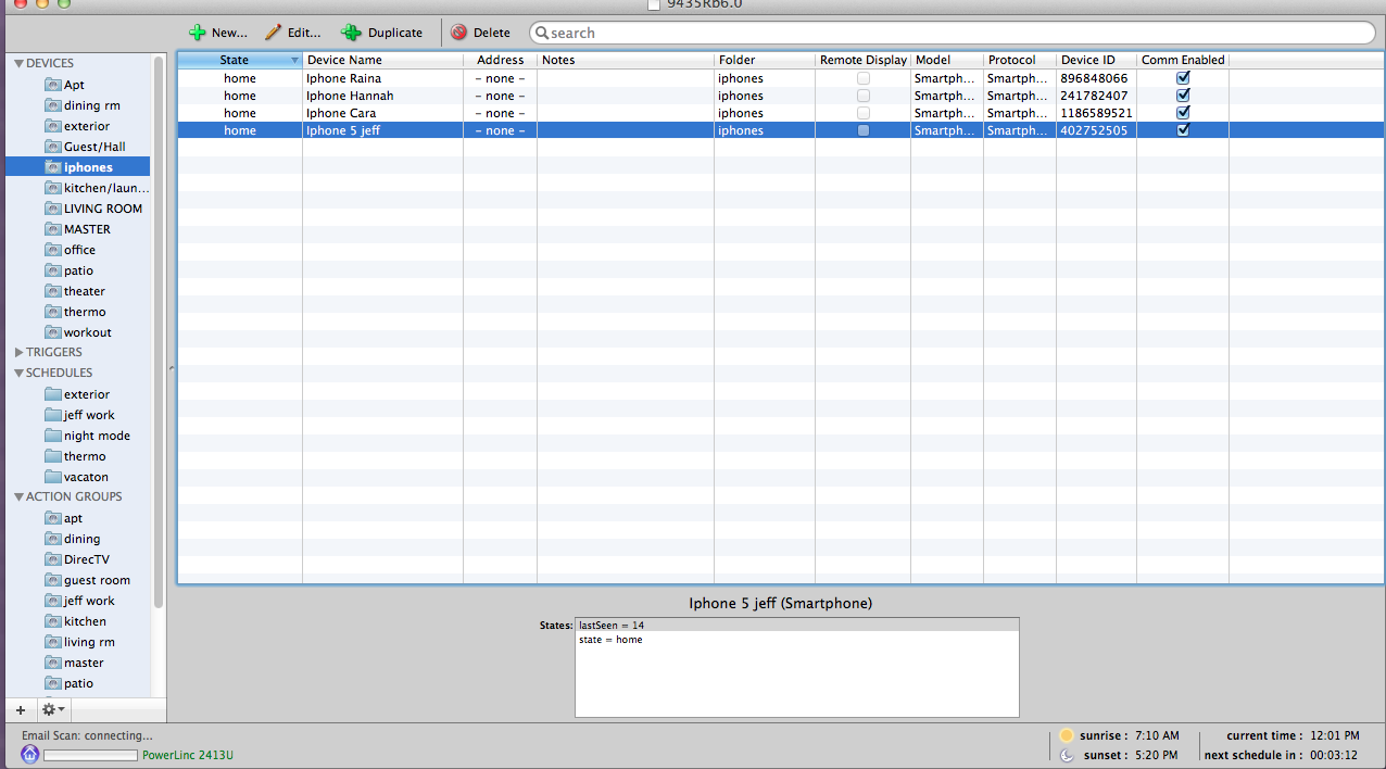

Ok, need some help. Just upgraded to indigo 6.0
I have 4 iphones as devices.
When trying to setup the router from the smartphone radar configuration window, there is no dropdown for router config?
First screen shot is from my computer and indigo. second from your initial post for set up instructions.
I have a year old time capsule 2 TB, various generation airport express' and a brand new uverse modem/router 3801HGV. My time capsule is set to "off" bridge mode, and "create a wireless network".
- showing iphone devices and "home"
- Screen Shot 2012-11-28 at 12.01.42 PM.png (122.8 KiB) Viewed 6670 times
- Screen Shot 2012-11-28 at 10.15.33 AM.png (81.89 KiB) Viewed 6670 times
- Screen Shot 2012-11-28 at 10.12.54 AM.png (85.2 KiB) Viewed 6670 times
Re: Smartphone Radar - Smartphone presence detection (Update
Pull down the "Plugins" menu, select Smartphone Radar, then Configure.
