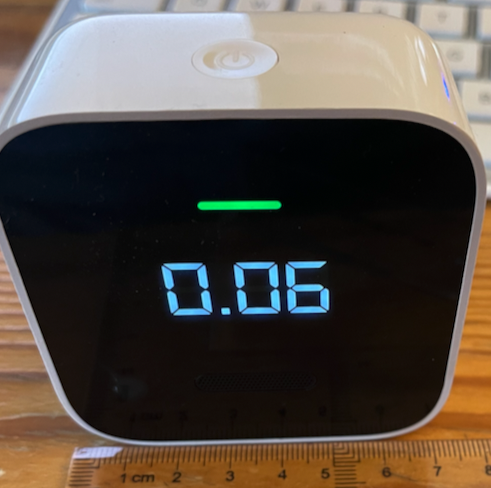

1. added BLE sensors: xiaomi formaldehyde sensor (in mg/m**3 or ppm)

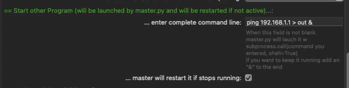

2. added option to start any command from pibeacon
this is managed by the pibeacon master.py program
it will make sure the program launches, and stays up and running if requested
set in rpi device edit, eg will make sure that ping ... will be running

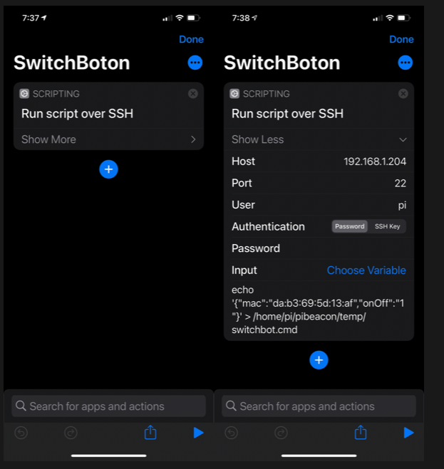

Added features / changes in v7.137.529@ 2021-06-28
switch bot devices --- these device can be used to physically switch an apple mini power button
they can be set through BLE eg:
gatttool -b xx:xx:xx:xx:xx --char-write-req -t random --handle=0x16 --value=57101 or 57102 for off and on
the rpi gets the command from indigo and sends these commands to the SwitchBot
next will be remote commands (through vpn or ssh or web interface) .
currently it only through indigo (or iPhone when in local network. w/o it it does not help when the indigo server is off to switch the indigo server on/off.
you could install their mini box that translates from BLE to wifi and access it remotely, but I am not fan of having things from other vendors allowing access to my network

1. added support for switch bot devices
they have to be "associated" to a single RPi in device edit
you need to first find the MAC # either through detect new beacons or through iphone app
then create switch bot indigo device add mac# and select RPi that is closest to device
rest should be left at default
then the device will behave like a relay
you can set the "hold" time with the iphone app

Added features / changes in v7.137.533@ 2021-07-02
1. switch bot now supports remote commands through ssh (ie iphone short cuts)
ssh pi@ ip# password then
echo '{"mac#":"xx:xx:xx:xx:xx","onOff":"1"}' > /home/pi/pibeacon/temp/switchbot.cmd
1. create shortcut
2. name it anything you like
add action: ssh (use find function)
fill out like shown below with the ip# of your rpi, userid =pi, password = your rpi password
replace the mac # with your switch bot mac # (use uppercase letters (A instead of a)
save, done
click on shortcut, it might ask you if you want to connect (only the first time)
then your switch bot short work
to use it over vpn
first start vpn, then click on shortcut, then wait , then disable vpn, will check if vpn activation can be added to the shortcut
1. create shortcut
save, done
to use it over vpn
- Screen Shot 2021-07-02 at 23.06.20.png (219.94 KiB) Viewed 5537 times
