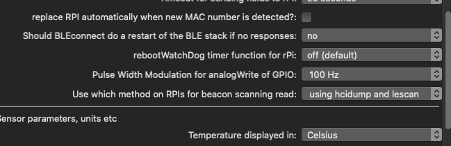

Added features / changes in v7.126.436 @ 2020-08-31
0. added new method (option) to read beacons using hcidump & lescan instead of python socket calls
1. added several "feasy" type beacons w battery level support in std message
2. added several "Minew" type beacons w battery level support in std message
3. added menu option to reload known beacon tags (for dev)
This new option can read manufacturing special message that are filtered out in the previously used python library calls.
this allows to read several new items
- battery level, and other message supplied measurements
- beacon manufacturing names
- and other info.
The default is the old version. You can switch in config at the bottom of RPI parameter settings:

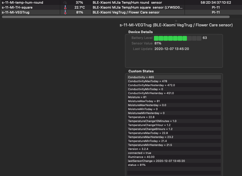

2. In addition to the Ruuvitag added several blue tooth sensors, very easy to setup, they all can be used as presence as well as sensors
   They have long battery life and > 30 m distance -- with several RPi in the house essetially the whole house is covered
	INGICS:
		iBS01-x: Family of on/off sensors- Button, magent, movement, external switch
		iBS01T:  Temp and humidity
		iBS01RG: x-y-z acceleration/ gravity sensor
		iBS02:   PIR presence ir IR object detection
		iBS03-x: Family of on/off sensors- Button, magent, movement, external switch
		iBS03G:  Movement detection of beacon on/off
		iBS03T:  on board temp sensor
		iBS03TP: on board temp sensor + temp sensor probe, water proved       ==> great temp sensor for a pool <====
		iBS03RG: x-y-z acceleration/ gravity sensor
    Minew
		E8: x-y-z acceleration/ gravity sensor
	iSensor - Kaipule
		various on/off sensors for GAS, CO water, alarm ...
		EN61, ES61, EW70, ET90, IM21, IX30 IX32
	Satech
		STixx sensors, acceleration, temp, humidity, on/off
