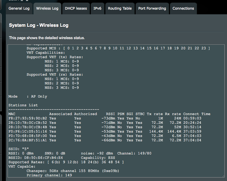

Also in the next release: each ipDevice will be its own indigo device. That will make it easier to trigger, sort, rename ...
If you can supply me with your router status page info I can try to include the info in the plugin:
I would need
- http://x.x.x.x/ >>>page address<<,
- the page dump (in safari or chrome go to view source code) to check if I can incorporate the info.
attached the page from an ASUS 68 and my view source code with the relevant section.
textarea cols="63" rows="30" style="width:99%;font-family:'Courier New', Courier, mono; font-size:13px; background:#475A5F;color:#FFFFFF" readonly="readonly" wrap=VIRTUAL>SSID: "2"
RSSI: 0 dBm	SNR: 0 dB	noise: -89 dBm	Channel: 6
BSSID: D8:50:E6:CF:B4:E0	Capability: ESS ShortSlot
Supported Rates: [ 1(b) 2(b) 5.5(b) 6 9 11(b) 12 18 24 36 48 54 ]
VHT Capable:
	Chanspec: 2.4GHz channel 6 20MHz (0x1006)
	Primary channel: 6
	HT Capabilities:
	Supported MCS : [ 0 1 2 3 4 5 6 7 8 9 10 11 12 13 14 15 16 17 18 19 20 21 22 23 ]
	VHT Capabilities:
	Supported VHT (tx) Rates:
		NSS: 1 MCS: 0-9
		NSS: 2 MCS: 0-9
		NSS: 3 MCS: 0-9
	Supported VHT (rx) Rates:
		NSS: 1 MCS: 0-9
		NSS: 2 MCS: 0-9
		NSS: 3 MCS: 0-9
Mode	: AP Only
Stations List
MAC               Associated Authorized    RSSI PSM SGI STBC Tx rate Rx rate Connect Time
F8:27:93:59:9D:B2 Yes        Yes         -73dBm Yes Yes No        1M     24M 00:59:03
28:10:7B:0C:CB:52 Yes        Yes         -71dBm No  Yes Yes    72.2M   72.2M 20:24:24
28:10:7B:0C:CB:4B Yes        Yes         -72dBm No  Yes Yes    72.2M     52M 30:52:14
F0:F6:1C:D5:51:16 Yes        Yes         -53dBm Yes Yes Yes   144.4M  144.4M 37:03:59
F0:7D:68:08:5F:D0 Yes        Yes         -43dBm No  Yes Yes    72.2M    6.5M 37:04:03
2C:76:8A:BF:51:A1 Yes        Yes         -66dBm No  Yes Yes    72.2M   72.2M 37:04:04
SSID: "5"
RSSI: 0 dBm	SNR: 0 dB	noise: -92 dBm	Channel: 149/80
BSSID: D8:50:E6:CF:B4:E4	Capability: ESS
Supported Rates: [ 6(b) 9 12(b) 18 24(b) 36 48 54 ]
VHT Capable:
	Chanspec: 5GHz channel 155 80MHz (0xe09b)
	Primary channel: 149
	HT Capabilities:
	VHT Capabilities:
		NSS: 1 MCS: 0-9
		NSS: 2 MCS: 0-9
		NSS: 3 MCS: 0-9
		NSS: 1 MCS: 0-9
		NSS: 2 MCS: 0-9
		NSS: 3 MCS: 0-9
Mode	: AP Only
Stations List
D8:A2:5E:63:7D:DF Yes        Yes         -73dBm Yes No  No       65M     39M 37:04:00
</textarea>

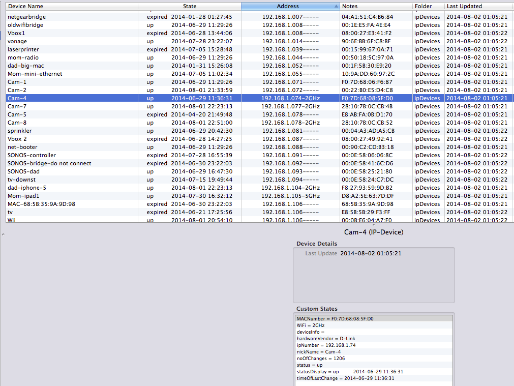

https://www.dropbox.com/s/3ntw3hkh8o5zk ... -4-6-1.zip v 4-6-1
NEW:
1) each ipDevice is now a device in indigo in a folder ipDevices.
you can sort for name, ip number, MAC number (and state somewhat... Matt/Jay need to enable value sort in this column. Indigo currently sorts status "type" -- would be really nice if that static value sort could be added.. :D )
the columns are:
--- name of ipDevice
--- status and date of last change
--- ip number and Wifi info
--- MAC number of device
2) reads ASUS 6x router wifi information
3) shows if the ipDevice is connected through wifi and which channel (if you have an ASUS router)
improves the recognition of a device in power save mode (sleeping iPhone). FING will likely set a sleeping iPhone to "down" mode while the router is still recognizing the connection.
FING actually is not slower than the router in recognizing a NEW or UP device (within a second accuracy)
If the router info is present it will overwrite the FING information.
Iif you want to supply your router info, I can add a connection to use that information.
4) you can create an action or schedule .. and select FINGSCAN action and select an ipDevice to ping. Results will be shown in the log file.. this is just a trial to see if one could use this for other purposes....
No change in EVENTS.
In config just the added fields to configure the router info.
how to use / install:
1) download zip
2) before you upgrade, clean up your device variables especially the "nickname". If nickname exists (and is unique and not iPhone-xyz) FINGSCAN will use it to name the device. If not, the name will be "MAC-macnumber" (you can change the name later in the device edit menu, also the vendor and device info can be edited in the device editor)
3) do a save to disk from the FINGSCAN menu, just in case. ... If you don't like it:. reinstall old version, delete all devices and reimport old data from disk.
4) double click on the plugin in your download folder and watch whats happening:
the new FINGSCAN will read the ipDevice variables and will create devices for each variable in a folder ipDevices
After that the variables are just output and any change will be overwritten. Master sources are the ipDevice, FING and the router -- it would be very difficult to maintain if you could modify the same info in 2 places.
2 weeks of work..
hopefully not too many bugs.. tested add, delete, sort, save to disk, restore from disk , rename, duplicate ....
as you can see I keep every device ever connected..
as for details: see the 3 digits in the last octet of the IP number.. changed 192.168.1.7 to 192.168.1.007 just for the display to make the sorting better
Screen Shot 2014-08-02 at 1.05.16 AM.png (233 KiB) Viewed 5653 times
