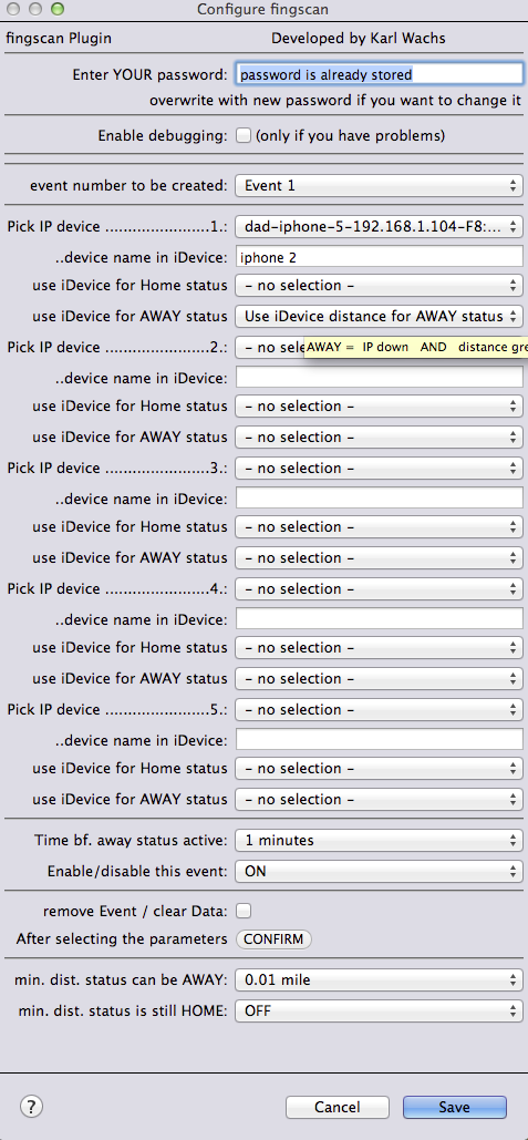

New:
- can set triggers in configuration menu for status away or back home
for
10 different scenarios (Event 1...10)
each with 5 different devices
each of the 5 devices has to be away for the Event- AWAY to trigger:
(a) on IP up or down with number of minutes required to be down before state is away
(b) add iDevice condition: # of miles away to be home or away
- home: idevice <xx miles OR IP up (==> if idevice still thinks its home its home), in case you switch off wifi)
- away: iDevice > yy miles AND IP down ( ==> its away only if IP down and distance > xx)
2 different miles values for away of home
the back home status is triggered ~ 1-2 seconds after phone connects to wifi. I am using it to open the front doors. Works 99% of the time.
Tried my best to make it user friendly
Have tested with 2 devices and idevice, but not idevice away as this would require starting, going away for some time and checking status coming back home ... That will take > 10 minutes per test cycle.
the attached screen shot show the 2 user screens (a) the config screen and (b) the trigger selection (after you select fingscan events)
left to be done:
- some more testing
- sorting the device list that is presented to the user.
- some performance tuning
- check if iDevice can increase frequency from 15/20 minutes to 5 minutes for update for distance
looking forward to your feedback.

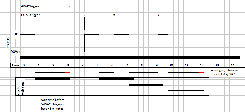

https://www.dropbox.com/s/clw6ju7cf69vx ... -4-0-4.zipv4-0-4
fixes:
away trigger was triggering FAR to often
attached a diagram that should explain when HOME and when AWAY triggers
the wait time is set in the config menu. a normal iPhone can be down for 15-25 minutes depending on power etc before it reconnects through wifi.
if you overlay the distance information from iDevice you get:
HOME: if iDevice distance < than set limit in config even if FING status is "DOWN", this will reduce the up/down cycles of an iPhone at home as the location information is still HOME
AWAY : if iDevice distance > than set limit in config even if FING status is (still) "UP" or still waiting the AWAY "wait time" ,
for example: if you leave home, the "wait time" is set to 30 minutes, AWAY will trigger e.g. if you are 1mile away (if distance limit is set to 1 mile)
A good suggestion is to set the HOME distance to 0.1 miles and the away distance to 0.5 mile. This will keep HOME alway on when you are at home and will trigger away as soon as you are more than 0.5 miles away or e.g. 30 minutes for the AWAY wait time.
When you come back home (my) iPhone connects within 1-3 seconds to wifi and the HOME trigger fires within 1-2 seconds after that. That means by the time I get to the door it is already unlocked Also if you enter the iDevice HOME radius (within 2 minutes in my setting) HOME triggers.

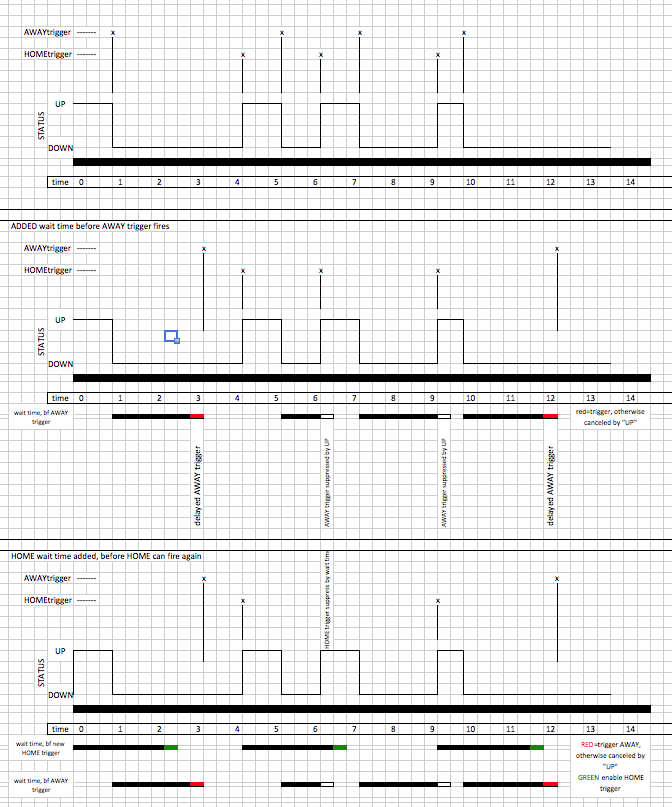

https://www.dropbox.com/s/eozk22xet0crl ... n4-5-1.zip V 5-5-1
added wait time for new HOME trigger, see attached schema to explain. It looks complicated but actually is not
the wait times are need to suppress triggers every 5 minutes or so when the phone decide to go to sleep or wake up again
This should be it, don't know of any other functionality one could get out of this.

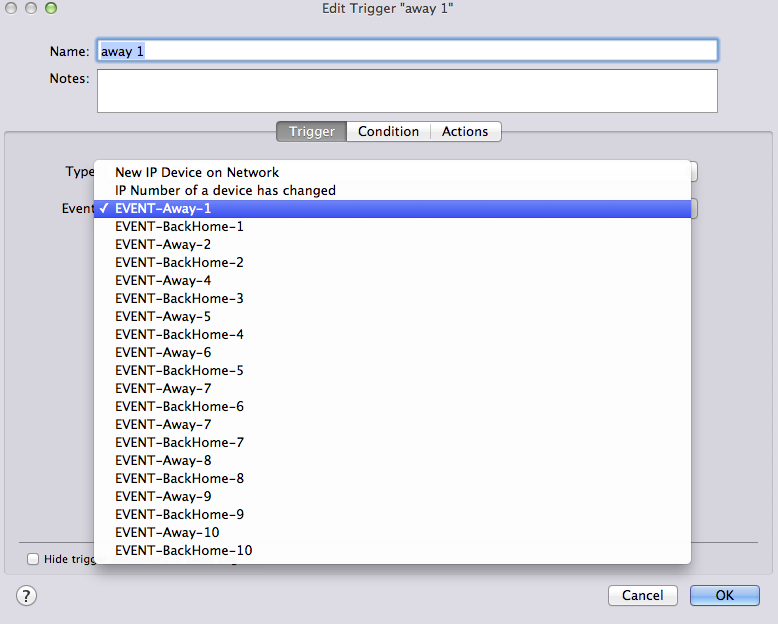

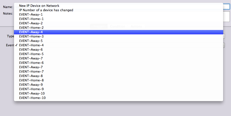

So far everything is working very good with this plugin. One small thing I have noticed. If you see the attached image, there is some mixup with the names, or sorting of the list.
besides from that it is working great!
Håvard
Håvard
- Screen Shot 2014-07-27 at 12.37.59.png (73.22 KiB) Viewed 4820 times
Håvard
will fix when I am back home tomorrow night, just a typoooo in the name field.
https://www.dropbox.com/s/0k1v4xl4ngydt ... n4-5-2.zip v 4-5-2
fixed typos in in event selection menu
Thank you for the awesome plugin Karl! Very responsive and now I can start thinking about getting a new 802.11 AC router as my extreme is on it's last legs!
