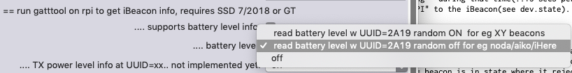

   Prep-steps::::::
     you MUST first edit each ibeacon indigo device and set enable battery level .. and select either
     "randown" or plain com to iBeacons.   xy beacons use random,  NODA, iHere .. use plain comm.
        you can try on the rpi with:
        hciconfig hci0 down
        hciconfig hci0 up
         for xy beacons:
           /usr/bin/gatttool -b MAC#  -t random  --char-read --uuid=2A19
         for iHere,  Noda ..
            /usr/bin/gatttool -b MAC#  --char-read --uuid=2A19
         replace MAC# with eg 0C:F3:EE:00:66:15 = the mac # of your ibeacon connected to that RPI
         the gatttool will return something like this (or an error message, can not connect)
             handle: 0x002f 	 value: 64
            where 64 is the hex value, into integer = 100%
        gatttool will conflict with the regular iBeacon message listening = during that time(..15 secs per ibeacon) no ibeacon messages will be received
        The RPI that is asked to get the battery level is the "closestRPI" to the iBeacon(see dev.state). When a beacon is not "up" it will not be querried and will keep its battery level unchanged
      In order to check if your SSD is supporting gatttol do: ssh pi@... gatttool.. if its says not found you need to upgrade your ssd

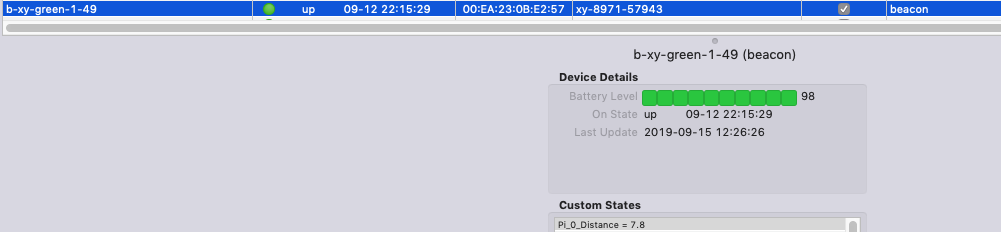

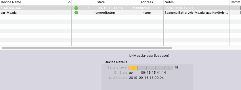

configure beacon device:
Screen Shot 2019-09-16 at 17.04.55.png (71.76 KiB) Viewed 5674 times
indigo device view shows % battery charge
Screen Shot 2019-09-15 at 12.26.34.png (29.55 KiB) Viewed 5674 times
Screen Shot 2019-09-16 at 18.00.35.png (30.98 KiB) Viewed 5673 times

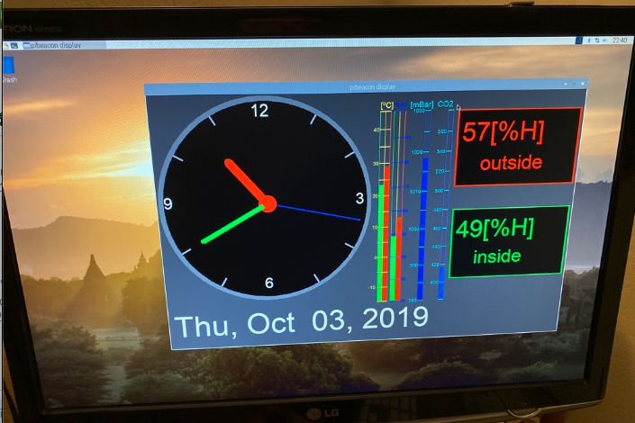

Added features / changes in v7.112.312 @ 2019-10-03
1. fixed situation when plugin deletes RPI, due to  MAC number =00:00:00:00:00:00 - bad data coming from RPI
2. tuned IMPULSE sensor
3. made # of digits for sensors consistent
4. added several options for display device on RPI
   - supports xwindows = can show composed (dynamic) images in window on rpi desktop
   - added "thermometer" item to display, w options for labels, ticks etc
   - added zoom factor for xwindows display.
   - it will automatically start xwindows on rpi when indigo output device is an xwindows device type
   - option in rpi device edit to start windows on RPI by rpi-master program
example to display on rpi screen:
