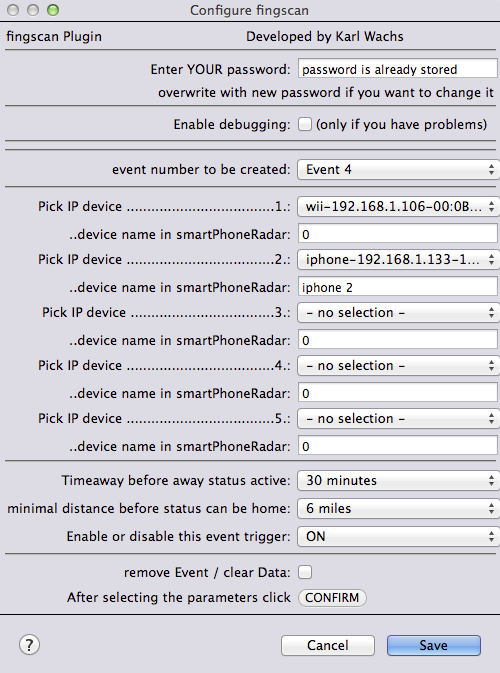

UPDATE for the next version, just started to work on it after INDIGOplotD...
the interface is ready, now on to the coding for the logic, that is normally the easier part .. at least for me. attached the menu structure
additional features:
- up to 10 different events/triggers can be generated with 5 devices that have to "off" for a definable time
- each devices can be picked by nickname/ ip-number/mac address from a menu
- an ixxx can be paired with smartphoneradar to set a minimal distance before events will fire
- each event has its own min OFF time before its 'away"
- this can also be used to trigger if e.g. the router is down or another device is gone from the network
any other features?

haavarda
Posts: 702
Location: Norway
Post by haavarda »
Sounds like got my needs covered... Looking forward to test it!
