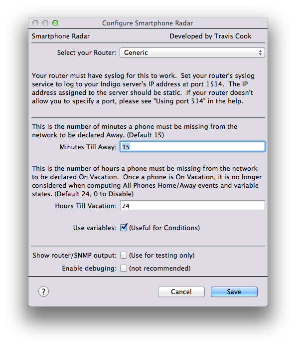

No option in the plugin config. I thought I had the latest version but the plugin is listed in Indigo as 1.1.3. I've seen 1.1.4 mentioned in the forums but try as I might, the last 30 mins, I cannot find the newer version.
EDIT: See screen grab.
Screen Shot 2014-04-29 at 10.27.46 pm.png (120.58 KiB) Viewed 5380 times

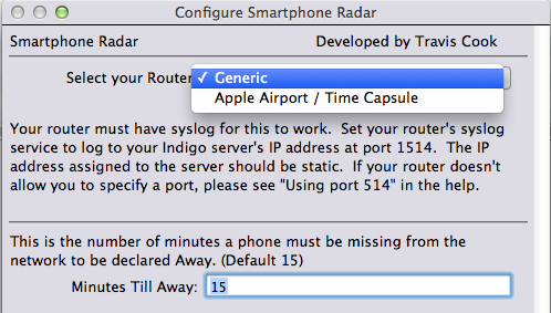

select fing as router
fin.tiff
fin.tiff (150.63 KiB) Viewed 5369 times

kw123 wrote:select fing as router
I wish it was so simple. Like I said, is this only available in Smartphone Radar 1.1.4? And if so where can I find it? I've spent the better part of yesterday evening looking for the link in the forums and on the Indigo site in general and only turning up 1.1.3.
If it isn't because of the version then I've no idea why I'm not seeing the option to select Fing in the router drop down menu. Fing is working correctly on my Mac.

I am now able to use Fing.log in Smartphone Radar. Have to say I don't think I was being stupid here. I decided to read every message from the beginning of this thread and noticed on page 4 of 14 a post from bip.philippe with a download link and a comment that Smartphone Radar was modified to work with Fingscan. Blink and you miss the post/link.
All the other download links for Smartphone Radar across this website are still at 1.1.3 and do not have the option to select anything other than Generic or Apple/Time Capsule.
I'm posting this here as others are undoubtably going to come across the same issues as I have. (In fact I saw another post earlier with exactly the same questions as I had but without any solutions).
