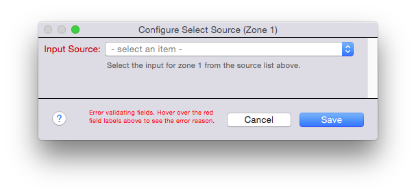

Thanks for the fast turnaround :D Zone 2 now populates the menu.
Question: For playing iTunes through the Pioneer, is the correct input source for zone 2 "MAC" or "Media Server" [or something else?]
Also, there is no data in this menu for Zone 1
Input Sourse Z1.png (38.78 KiB) Viewed 8379 times
Sep 26, 2015, 12:15:10 PM
  Pioneer Receiver Error          Error in plugin execution GetUiDynamicList:
  File "plugin.py", line 4851, in uiSourceList
<type 'exceptions.KeyError'>: key source48label not found in dict

If I recall correctly, this Zone 1 menu DID populate with data before the v1.0.7 update [if that helps you]
nsheldon
Posts: 2469
Location: CA
Re: Pioneer Receiver discussion
Post by nsheldon »
Version 1.0.8 Released
  • Fixed another bug that caused the plugin to crash when communicating with the VSX-1123-K.
Hopefully that'll fix the error introduced in 1.0.7. I don't have a VSX-1123-K to test with though, so there may be other errors.

v1.0.8 seems to work nicely with the 1123 :D
