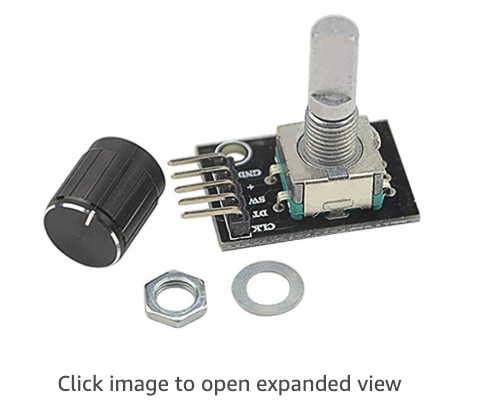

2. pulse generating rotary switches
Screen Shot 2019-02-04 at 16.30.30.png (123.91 KiB) Viewed 4738 times
Indigo states:
Screen Shot 2019-02-04 at 16.36.19.png (3.14 KiB) Viewed 4738 times
DO NOT connect V+ to +5V. These switches no not have any electronics on board, just a 10K resistor V+ to signal pins. either remove the resistor or connect V+ to 3.3V
For hardware debouncing see: http://raspberrypihobbyist.blogspot.com ... input.html
The text in status field can be freely set in device edit, and you can multiply the number with anything you like.
The indigo device edit gives some advice on how to connect.
you can have several of these devices in parallel with different GPIOs at the same RPI -- tested with2.

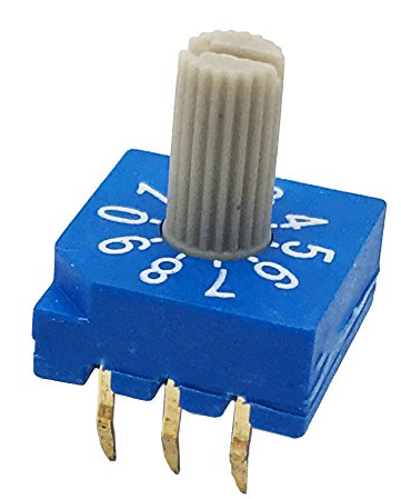

1. finalized rotaty encoded switch devices
	A absolute position
		read encoded n pin rotaty switch, send integer value to indogo every 90 secs or if changed
		grey code = only 1 bit changes pre step
		    eg http://www.grayhill.com/assets/1/7/mech_encoder_26.pdf
		regular binary; normal binary code
		   like also: https://www.amazon.com/gp/product/B071F4QM6L/ref=ppx_yo_dt_b_asin_title_o06__o00_s00?ie=UTF8&th=1

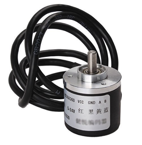

		Bourns table encoded:
			special bourns devices that comes with an 8 bit 0-127 value encoding
			    https://www.bourns.com/pdfs/ace.pdf
			    pins 1,2,G,3,4   8,7,G,6,5
				0-127 positions
		Bourns serial device that is read like SPI, but just very simple code
			    CLK, CS, DO= read data. it is 10 bits + some status bits
			    pins: Di,CLK, GND, Do, V+, CS, connect CLK,GND,DO,V+,CS; CS can be set HIGH permanently , use V=3.3V not 5V

example for rotate switches:
1. absolute:
Bourns 1024 potions
Screen Shot 2019-02-10 at 21.11.11.png (40.48 KiB) Viewed 4694 times
Grey encoded 16 pos:
Screen Shot 2019-02-10 at 21.11.20.png (23.42 KiB) Viewed 4694 times
2. continuous 100 steps/ 360:
Screen Shot 2019-02-10 at 21.11.32.png (192.74 KiB) Viewed 4694 times
