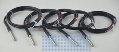

I have to many temp sensor... does anyone need a Onewire waterproof D18B20(-55°C to +125°C), have 2 spares (I have in total 13 temp sensors.. that is plenty)
if you donate something to e.g. the refugees in Europe or the charity of your choice I will send you (sorry only in the USA) 2 sensors prewired with connector, resistor .. ready for the piBeacon
