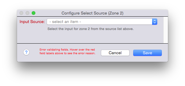

I finally got around to using your Pioneer plug-in :D , but I'm getting this error.
Sep 25, 2015, 1:57:59 PM
  Pioneer Receiver Error          Error in plugin execution GetUiDynamicList:
  File "plugin.py", line 4876, in uiSourceList
<type 'exceptions.KeyError'>: key source48label not found in dict
It seems to be coming from "select input source", where there are no selections in the pull-down menu
Zone Input.png (39.01 KiB) Viewed 5342 times
Plugin v1.0.6
Pioneer VSX-1123
OS 10.10.3
Indigo 6.1.1
CraigM

Pioneer Receiver Error          Error in plugin execution ExecuteAction:
  File "plugin.py", line 3116, in zone2setSource
<type 'exceptions.KeyError'>: key source not found in dict

nsheldon
Posts: 2469
Location: CA
Re: Pioneer Receiver discussion
Post by nsheldon »
Version 1.0.7 Released
  • Fixed 2 bugs that caused the plugin to crash when communicating with the VSX-1123-K.
nsheldon
Posts: 2469
Location: CA
Post by nsheldon »
Hi Craig.
Hope the 1.0.7 update fixes all the errors. However, there may be more as I don't have any VSX-1123K to test against. Let me know if you see other errors.
