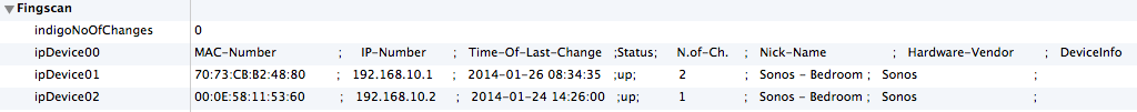

I have a problem with the nick-names changing randomly. I have sorted them by IP recently, which I've not done before so not sure if that has anything to do with it. But I have about 40 items listed and three or four now have duplicate nicknames along with the hardware tag also being incorrect. My iPhone for instance is now shown as a Nest smoke detector! But the actual functionality does still seem to be correct.
For instance, in the screenshot the Sonos is 10.2, but the 10.1 entry is actually an apple device, I have changed them back and it reverts again after a while.
- Screen Shot 2014-01-26 at 10.17.25.png (28.82 KiB) Viewed 5280 times
will check it out
could you give me some more info when this happens.. e.g. adding a device, deleting a device ..
I don't think that I did anything different, but it has only just started to happen within the last week maybe.
I'll set them back to what they should be and see what happens. Could it be anything to do with the load / save functions, I've only just started to try them out.....
On second thoughts, I did do some pruning of old expired IP's in the last week, it make be linked to that....
