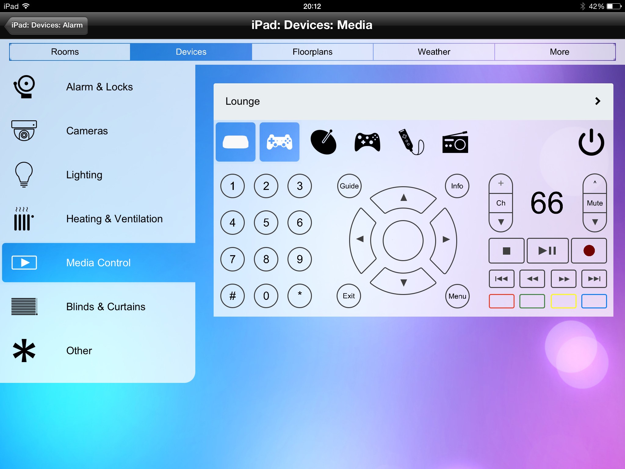

On a completely different note i've been having an issue with image heuristics on control pages that only seem to relate to this plugin (but i don't use them heavily at the moment so it may be something more indigo specific than the plugin).. its been an ongoing issue for some time but i've only just had time to look into troubleshooting it properly. Basically i have images to display to show what source is currently active using the "zone1source" numbers from the devices list which works perfectly, except for a conflict between source 25 for my PS3 and 22 for my AppleTV. If the Apple TV is active then the button for the PS3 also shows as active, but if the PS3 is active only it shows correctly. I've checked the image names and they're all correct (e.g. PS3+.png and ATV+.png as the basic images which show as off, then PS3+25.png and ATV+22.png for the on images) and i've even when so far as to setup indigo on a completely stand alone device, create a new database and device and try the same thing and same issue occurs. It also happens regardless of device it's viewed on.. including on the completely fresh test system when loaded in safari so it can't be a caching issue. If i get the control pages to show just the source number then it lists the correct number (22 or 25) and this issue doesn't happen with any other devices, so when it's set to say the radio (source 2) it works perfectly... Any ideas?
- screenshot.jpg (275.96 KiB) Viewed 6096 times

Re: Pioneer Receiver discussion
I wonder if the 3 in the filenames PS3 is messing up the heuristic. It shouldn't since that is before the + character in the filename, but it is worth experimenting around with.
So try removing the 3 from all the PS3 image filenames (or change it to THREE). Does that get it working?

Hi Durosity.
While Matt's suggestion warrants investigation, I think that with the way you have the images set up, that's actually expected behavior by Indigo (see this wiki article on the topic, especially #2 under "Image Selection Heuristics"). If an exact image name match for a numerical device state value is not found, Indigo will look for the next closest image name rounding up to the nearest 5, then 10, then 20, then 25. Since you only have 2 PS3 device state images (media-source-icon-ps3@2x+.png and media-source-icon-ps3@2x+25.png), when you select source 22 (your Apple TV), Indigo looks for media-source-icon-ps3@2x+22.png for the PS3 icon. Since it can't find that image file it then rounds the image file number (22) up to the nearest 5 (25) and looks for that numbered image file, which it finds.
The only way to work around this behavior that I know of is to simply duplicate your media-source-icon-ps3@2x+.png file and rename the duplicate to "media-source-icon-ps3@2x+22.png". If you use input sources 21, 23, and 24, you'd also need to create duplicates of the media-source-icon-ps3@2x+.png image and name them media-source-icon-ps3@2x+21.png, ...+23.png, and ...+24.png.
Aha, yep.. spot on Mr Sheldon.. of course what i don't get is why it wasn't doing it for source 23 (xbox) or indeed the other way around, but creating a duplicate of "media-source-icon-ps3@2x+" and naming it "media-source-icon-ps3@2x+22" has resolved the issue.
Thanks for the idea!
PS Matt, renaming PS3 to PS didn't make any difference so that side of things seems to be working solidly! I guess this is another one to add to your mammoth request list, the ability to set the heuristics for individual items to some sort of 'hard' setting rather than it looking for the closest number... (which in itself is actually pretty cool.. i was kinda aware of that function before but never really used it to that level.. opens up a lot of possibilities for me!)
