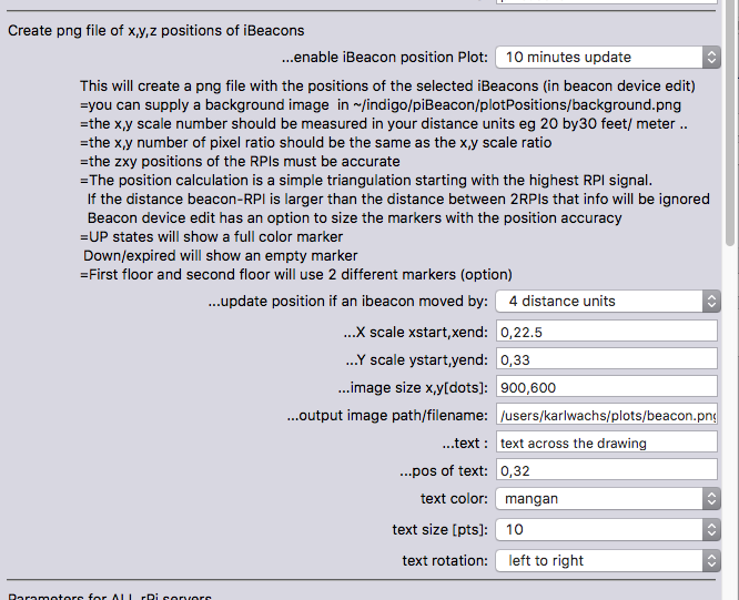

posted v 7-69-155
added:
show positions of iBeacons in a png file.
first enable the function in config:
Screen Shot 2017-10-13 at 21.47.44.png (129.32 KiB) Viewed 5182 times

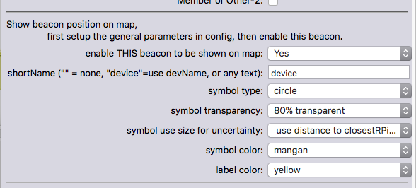

Then enable the beacons you would like to sho in beacon device edit:
Screen Shot 2017-10-13 at 21.48.18.png (48.86 KiB) Viewed 5182 times

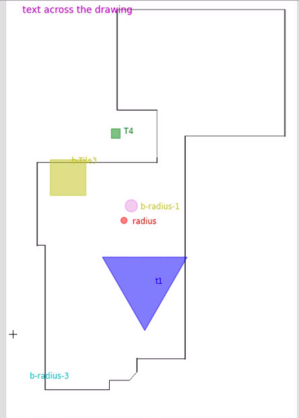

This will create something like this
Screen Shot 2017-10-13 at 21.57.23.png (48.69 KiB) Viewed 5182 times
As you can see some of the options eg. triangle do not make much sense.. but for fun left them in.
The image file is run through compress (pngquant). That reduces the size by at least 50%.
The process produces its own log file in ~ /indigo/pibeacon/plotPositions.log
The temp etc files are in ~/indigo/piBeacon/plotPositions
As you can see I am not that gifted with graphics .. but the tool works fine .. you can use any fancy drawing file (png) of your home as background.
