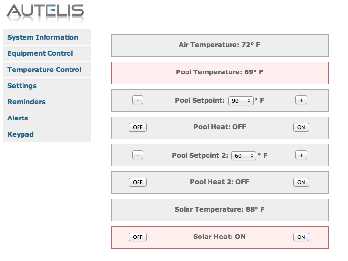

Just had a solar heater installed yesterday and have not been able to see / control it via the plugin. However, can see Solar Temp and control Solar Heat via the Autelis webpage via LAN.
Is there a way to grab the info into the Plugin?
Here's the Autelis webpage, which shows the Solar heater is ON and the Solar Temp is 91 degrees:
Screen Shot 2012-11-21 at 11.16.44 AM.png (48.46 KiB) Viewed 5112 times
Just can't seem to see anything in the Plugin that displays the Solar Temp or allows display or control of the Solar Heater. Here are a series of screenshots that show all the Plugin variables (taken at the same time as the Autelis screenshot above):

Can you put the plugin in to debug mode and restart it. I want to see what is returned on the poll for solar detail.
Thanks.

Sure. Here it is. (I also changed the plugin from 1 Aux to 15 Aux right before changing to debug mode).

I have no way of testing, but pretty sure I found the error. Thanks for running the debug. Please download v1.06 from the Wiki Page.
-Nick
eme jota ce
Posts: 655
Joined: Thu Jul 09, 2009 1:25 pm
Location: SW Florida
Re: Autelis Jandy
Post by eme jota ce »
Thanks a lot. And Happy Thanksgiving. :D
I can now see the Solar Temp value and can see the status of the Solar Heater as either "On" or "Off" in the Plugin, which is great.
This next knit-picky comment is nothing immediate but might be addressed when you have an inclination to update the plugin for your own needs. It appears that the Autelis (or the Jandy) has three states, not two, for the Solar Heater: Enabled, On, and Off.
"Enabled" in the Autelis / Jandy appears to mean that the pool is calling for heat because its temperature is less than the set point, but the three way valve still bypasses the solar panels because running water through them would either not heat the pool or might cool it. As soon as there is enough heat at the panels. The Autelis status switches to On when the difference between the solar temp and the pool temp indicates that the panels can heat the pool and the valve is turned to divert water through the panels.
The Plugin appears to indicated "On" for the Autelis states of both On and Enabled.
