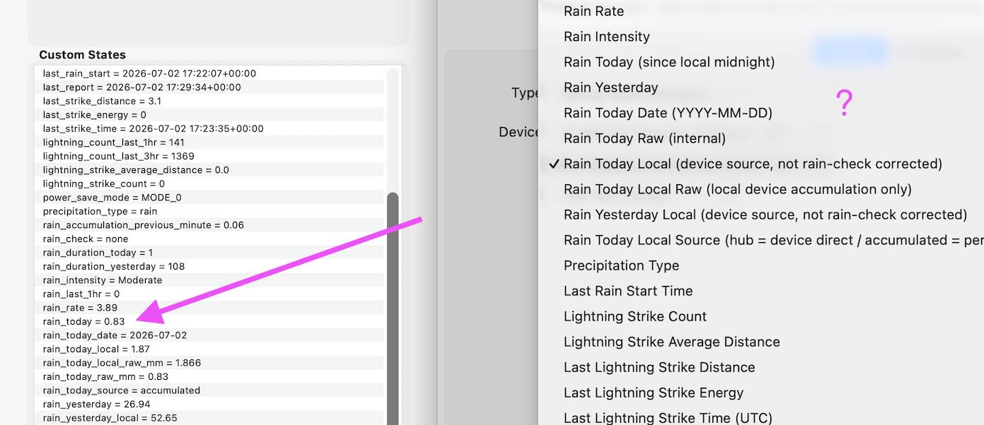

Soooo which Trigger point on the RIGHT corresponds to the State on the LEFT?
Looking for a Trigger that will fire every time the "rain_today" changes.....
Trigger Point.png (467.92 KiB) Viewed 147 times
GlennNZ
Posts: 1870
Re: Weatherflow Tempest Weather Station (New Plugin)
Post by GlennNZ »
Potentially the one you are after is Rain Today since local midnight - that reflects the one you are pointing to.
Rain states — two families
There are two parallel sets of rain totals. When you open a Device State Changed trigger the list shows both, which is where the confusion comes in.
Family 1 — WeatherFlow cloud values (rain-check corrected)
These come from the WeatherFlow web API. WeatherFlow runs a Rain Check algorithm that cross-references nearby stations to filter out
false triggers (spider webs, bird impacts on the sensor) and adjusts the total accordingly. This is the same number the WeatherFlow app shows you.
  • Rain Today (since local midnight) — the one to use. Updates every minute, resets at local midnight.
  • Rain Yesterday — yesterday's corrected total.
  • Rain Today Raw (internal) — internal mm store used by the plugin. Ignore in triggers.
Family 2 — Local UDP values (raw, no rain-check)
These come entirely from UDP packets broadcast by the hub — no internet required. The sensor reports how much fell in the previous minute and
the plugin accumulates it. No Rain Check correction is applied.
  • Rain Today Local (device source, not rain-check corrected) — raw running total for today.
  • Rain Yesterday Local (device source, not rain-check corrected) — yesterday's raw total.
  • Rain Today Local Raw (local device accumulation only) — internal mm store. Ignore in triggers.
  • Rain Today Local Source (hub = device direct / accumulated = per-minute fallback) — diagnostic string showing how the local total was
    built. Not a number — ignore in triggers.
For a trigger that fires every time today's rain total changes → choose Rain Today (since local midnight)
It fires roughly once per minute while rain is accumulating. If you want to avoid it firing on the midnight reset back to zero, add the condition: new
value is greater than old value.
jltnol
Posts: 1162
Post by jltnol »
Wow!
You answered my question and even my next question, which was what all those different rain amounts mean. I'm using the MatPlotlib plugin to create a rain bar graph, and once the trigger fires, does some conversion from MM to inches, and after a few more steps, creates the graph. And I have a schedule at 11:59PM that disables the trigger, does some number rotations, then re-enables the trigger at 12:01AM.
