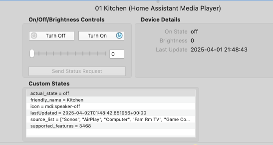

I reloaded the new plugin, but this time I stopped and re-started the server. It does show the "source" once the plugin is re-started. However, this dimmer action script, which works in 2024, does not work in 2025?
indigo.device.turnOff(1737882882) #Kitchen
Re: HA plugin is terrific. Some help in scripting?
hamw wrote: Tue Apr 01, 2025 5:57 pm I reloaded the new plugin, but this time I stopped and re-started the server. It does show the "source" once the plugin is re-started. However, this dimmer action script, which works in 2024, does not work in 2025?
What HA device class is that?
hamw
Posts: 1342
Post by hamw »
It looks to me, from the device status and states list, that it functions like a dimmer. I also tried:
indigo.dimmer.turnOn(1737882882) #Kitchen
indigo.dimmer.setBrightness(1737882882, value=15)
And it works as expected, turning the zone on and setting volume.
So I reloaded v2025.5, rebooted the Mac, and the dimmer on/off and set brightness commands do not work.
 Embedded script executor host2 started
   Home Assistant Agent Warning    01 Kitchen: actionControlDimmerRelay: media_player.xantech8_kitchen does not support TurnOn
No issues; I will just go back to 2024. Not sure if this change may affect other HomeAssistant devices.
