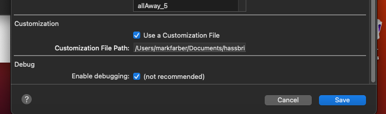

OK Thanks... but where is the debuggin level status option cuz the plug-in only has one check-box to turn on debuggin without any levels?
Screenshot 2023-07-18 at 2.23.49 PM.png (37.89 KiB) Viewed 2706 times
Re: HassBridge plugin updated for Python3
Oh, I guess I didn't update that section of the code. I'll try to remember next time I'm in there.
