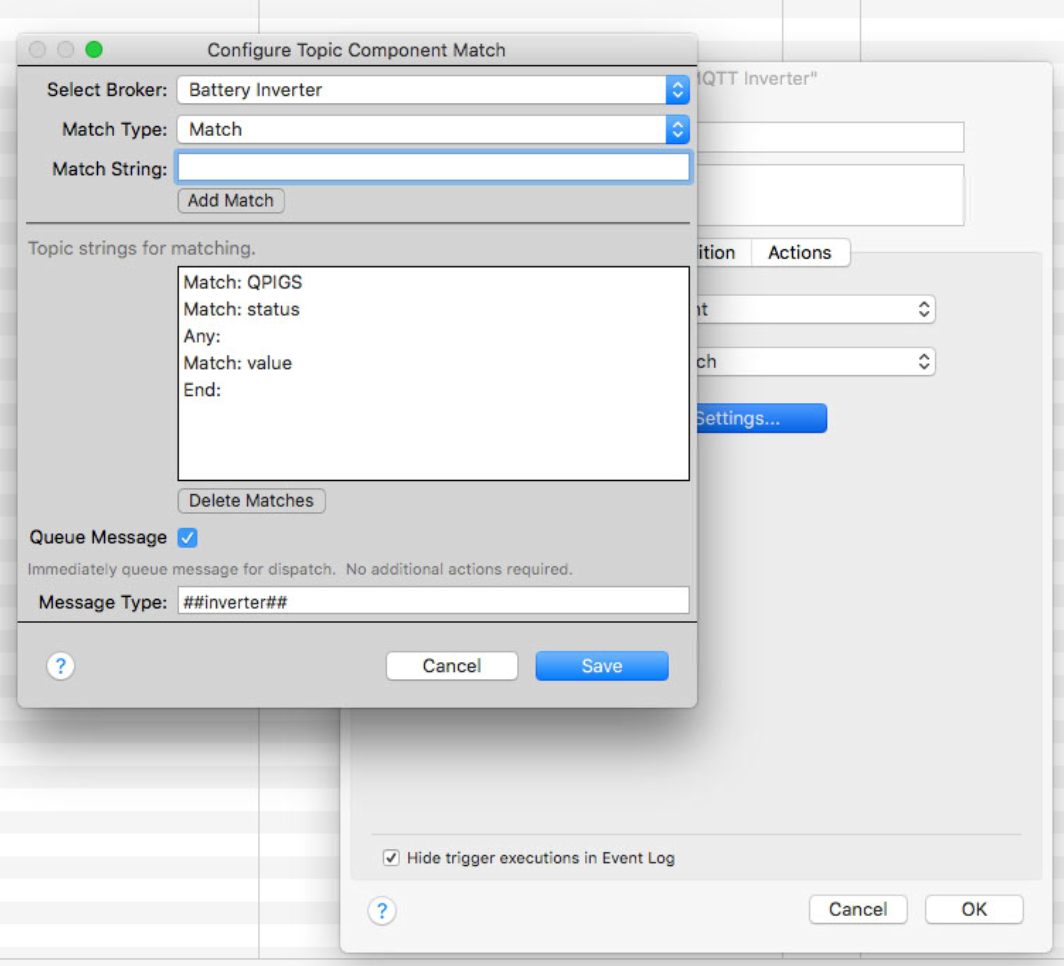

Screenshot 2021-04-16 at 22.07.30.png (382.23 KiB) Viewed 2152 times
Re: UnicodeDecodeError: 'ascii' codec can't decode byte 0xb0
What's the actual topic and payload that's triggering the error? You should be able to see that in the debug logs.
