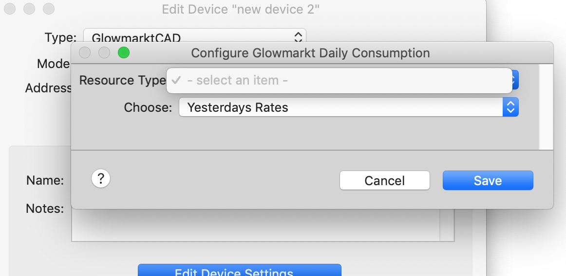

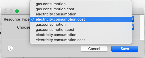

Thanks for that, I tried to fake a response from the API with duplicate resources and while it was confusing the list still populated with double entries so it looks like something else is happening. Please do send me the full log, and if I cannot make sense of it I will prepare a version with more detailed logging. Just to confirm it is the resource type list that does not populate in the device settings, as per my duplicate one below
Neil

It is the resource list that is not populating.

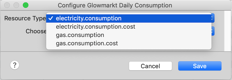

So this morning I tried a different approach, What I hadn't done before was to shutdown indigo server before deleting the plugin pref file. That did the trick, rebuilding the pref file. The resources drop down is now populating properly. All good now.
