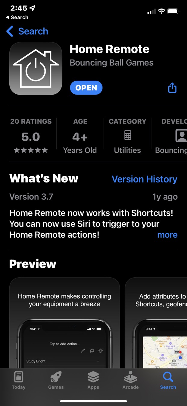

Thing one: The Home Remote app that I'm using has a fair bit of Indigo integration built in. The UI is a bit unusual, but once you get the hang of it, it works really well. After you establish a Device or Action within the app, it's one click to add the device to iOS Shortcuts (with included Siri integration). It has GeoFencing, a widget, and Apple Watch, and Apple TV integrations. It also does:
  • HTTP GET,
  • Milight,
  • LIFX,
  • WeMo,
  • TCP/UDP, and
  • Multi Action.
If you have any questions or want more details, just holler.
Thing Two: I reset everything just the other day and was able to pull in the HKB hub and Indigo devices. The devices appeared to work 100%. I was able to pull in Actions, but those didn't work at all. Could be I got "lucky". There were a few Python errors when I did a clean install of HKB, but they didn't appear to be fatal. I didn't look under the hood to see if I could repair them. I don't think the errors had anything to do with the Actions not working, but that's just a guess. I was using HKB mostly to use Siri to fire Actions, so I was dead in the water at that point.
