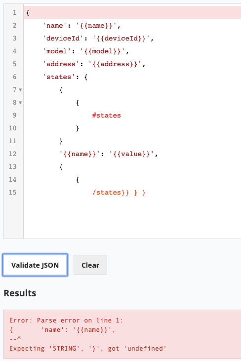

Not sure if it is relevant, but when I try to validate the json that is the default device template I get the following. Is there an error in the json?

The template itself is not valid JSON. You need to attempt to validate the string after it's gone through the template engine and the values have been substituted into the template.
Turn on debug logging, update a device that's published, and look in the log. You'll see a line like this:
The string after the "payload = " should be valid JSON:
MQTT Connector Debug Motion Sensor: deviceUpdated: publishing device - payload = {"name": "Motion Sensor", "deviceId":"900634645","model": "Example On/Off Sensor Module", "address": "123456", "states": { "backlightBrightness": "0", "onOffState": "False" } }

I did just make a change so that the default templates use double-quotes instead of single quotes. Try changing your template to this:
{"name": "{{name}}", "deviceId":"{{deviceId}}","model": "{{model}}", "address": "{{address}}", "states": { {{#states}} "{{name}}": "{{value}}", {{/states}} } }

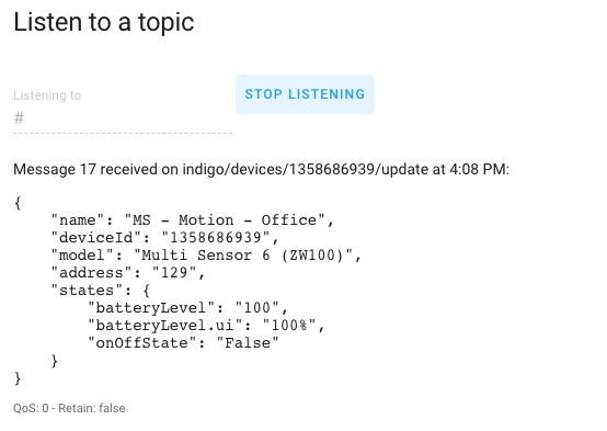

I tried your double quotes, but no success. It looks like the picture below when recieved on HA. And the variable is working instantly... So a bit confusing.
- Skjermbilde 2020-03-20 kl. 16.09.52.png (38.91 KiB) Viewed 2655 times

Re: MQTT comunication between Indigo and Home assistant
That certainly looks correct. What's the config.yaml entry look like?
Excellent!
I tried one more time with the doubble quotes and your suggestion for value_template, and now it seams to update
