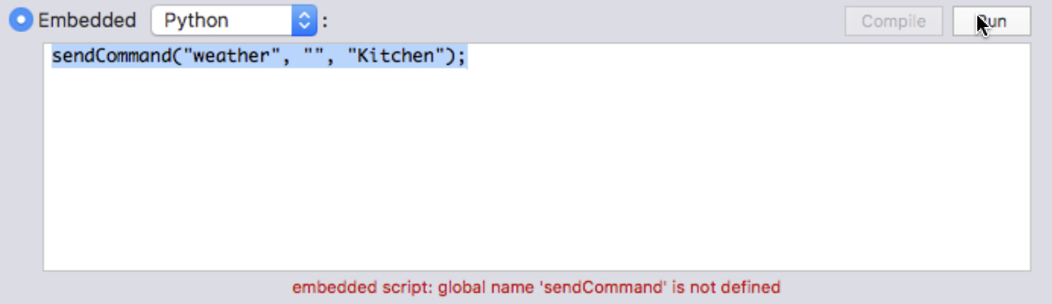

Finally got it installed but am missing how to execute the scripts in Indigo.
Also, I’m hoping it’s possible to send the contents of a variable to speak?
Any help appreciated!
Carl

The steps I posted above were just to provide an example. The scripts do not integrate at all with Indigo. Although, my original purpose for this thread was to see if I could override Indigo’s speech function in an effort to create such an integration.
I don’t think overriding the function in Python will work, so maybe I’ll come up with another method when I have time.
Right now I’m just setting an Indigo variable with the text I want spoken, and a trigger runs a script when that variable changes to send the command to Alexa (then sets the variable back to empty).
