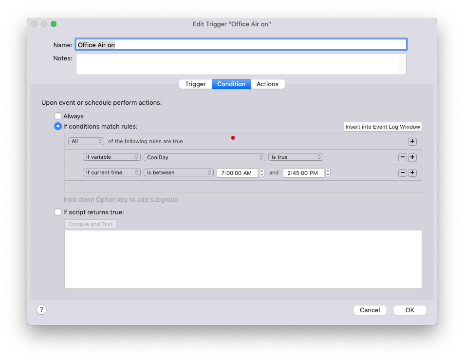

What's in the "Conditions" tab?mikejandreau wrote:Doesn't look like this is working, unfortunately.
You can see in the top of my screenshot that my Office Thermostat is 79F now and my Trigger is "Becomes Greater than 78" but my trigger didn't trigger.

Nothing too fancy. Just a variable being true and a time check (for when I'd be in my office).What's in the "Conditions" tab?
- gbzgg.png (132.97 KiB) Viewed 3999 times

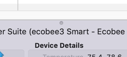

When you have the Nest selected in the device list, drag up on the little "dimple" just at the top of the device details pane:mikejandreau wrote:Not sure what you mean by "window beneath the Thermostat Controls".
Can you elaborate on what window I should be looking in here?
- Screen Shot 2019-07-12 at 10.42.29 AM.jpg (17.66 KiB) Viewed 3999 times

Are you sure both of those are true while you're testing?mikejandreau wrote:Nothing too fancy. Just a variable being true and a time check (for when I'd be in my office).What's in the "Conditions" tab?

Yep. 100% positive.
