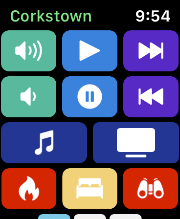

Roon control via Apple Watch
Post by chickenlittle »
I love this plugin, thanks Autolog!
I have some basic controls of Roon setup on the Apple Watch.
I create action groups that trigger simple transport controls through Roon plugin. pause, play, previous, next, volume up and down by a certain amount.
I then use HomeKit bridge to assign those action groups to Siri commands.
I then create a Scene on iPhone (using a program like Home+) to control each Roon/Siri command (this is needed for the next app).
I then use an iOS app. HomeRun to create a screen with icons on the Watch, each of which trigger a Siri scene, which triggers an action group in Indigo, thus controlling Roon.
The top two rows of the attached image are icons controlling Roon.
Roon Apple Watch.PNG (37.67 KiB) Viewed 18368 times
