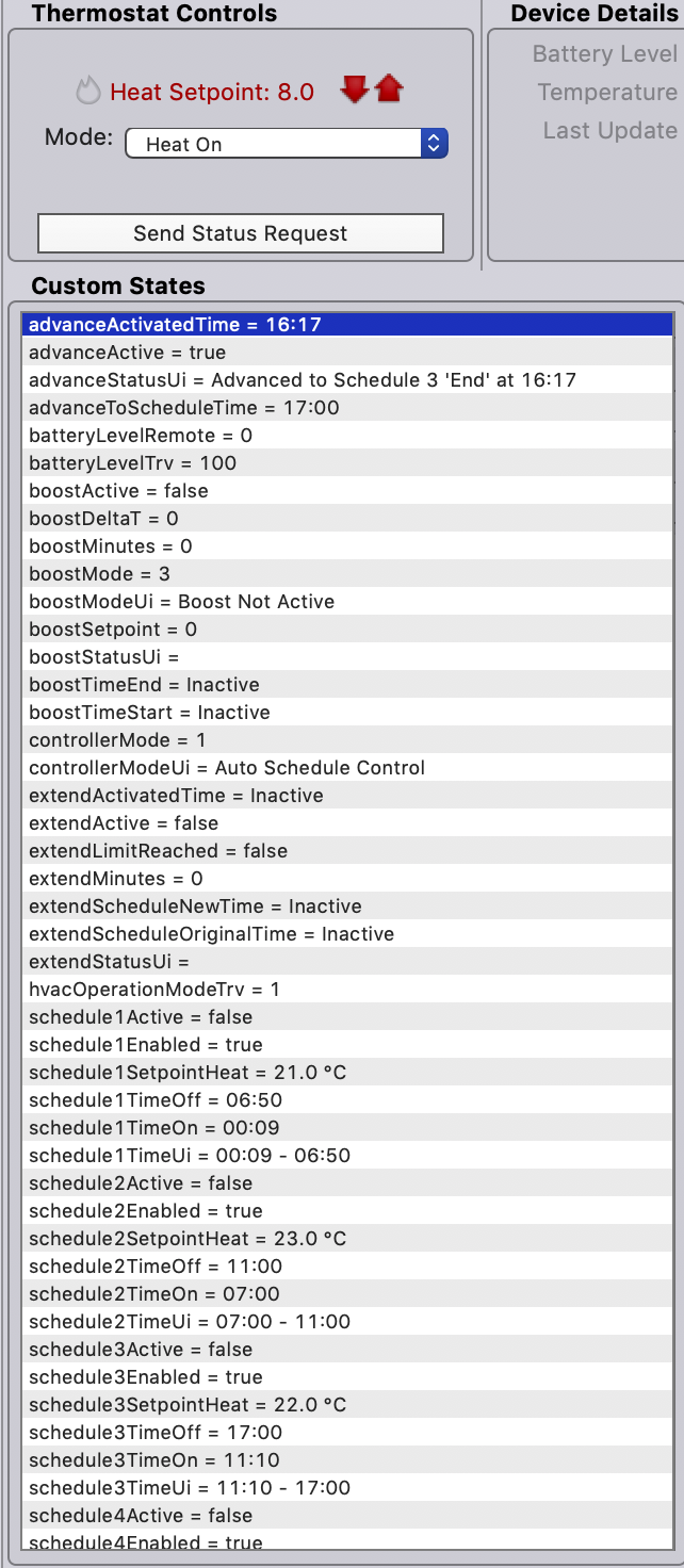

Could you pls explain how the advance action works? My understanding was that it would switch to the next schedule i.ex. from 3 to 4. I have done it but it turned the valve off and after a few minutes TRV setpoint is at 8 deg not at 23 deg as it's supposed to be or the next schedule.
Is it correct or I'm missing something.
Kind regard
Ryszard
Here are the settings:

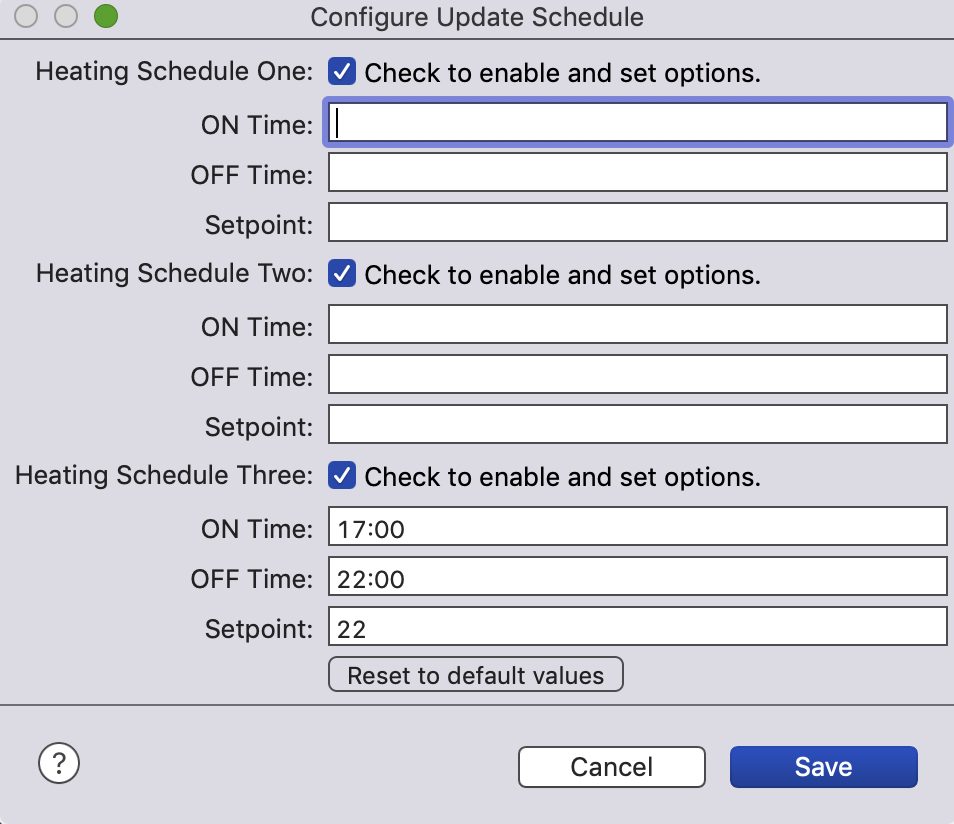

Just have noticed that "Update schedule" action has still 3 schedules :|
Screenshot 2018-12-23 at 17.29.51.png (244.71 KiB) Viewed 3793 times
Ryszard

richo wrote:Just have noticed that "Update schedule" action has still 3 schedules :|
This is fixed (I hope) in BETA 3 - will upload shortly. :)

richo wrote:... Could you pls explain how the advance action works? My understanding was that it would switch to the next schedule i.ex. from 3 to 4. I have done it but it turned the valve off and after a few minutes TRV setpoint is at 8 deg not at 23 deg as it's supposed to be or the next schedule. ...
Advance, advances to the next schedule point (either the start or end).
So if you are not currently in an active ON schedule period and then select Advance, It will advance to the next schedule ON.
Effectively, turns the next schedule on early.
Likewise, if you are in an active ON schedule period, it will advance to the end and turn the schedule OFF.
Effectively, turns the current schedule off early.
Hope this explains it OK. :)
Hmm, why wouldn't it start the next schedule if it's just after the current active one?
i.ex. I have an evening schedule for studio that starts at 5pm and it rises the temperature. If I get home early I'd like to start this schedule sooner - I thought that Advance action would allow me to do it. Ideally I'd like to start this schedule automatically on my way home :D
Ryszard

richo wrote:... Hmm, why wouldn't it start the next schedule if it's just after the current active one?
It will (or should :wink: ).
If the schedule is currently off - when you invoke Advance, it will start the next schedule. :)
Are you saying that this isn't happening?

  • I have also corrected the Update Schedule Action so that it handles the four schedule times and also added in an action to reset the schedule back to device defaults. This functionality could, for example, be used to alter the schedules at the weekend. :)
