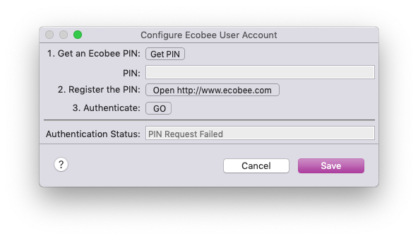

Re: Ecobee Version 2 - Beta test version available
I've just installed the 2.0.2 plugin.
1) I'm getting authentication errors with both 1.2.8 and 2.0.2 when I request a new PIN
- error message from 1.2.8 is "Ecobee Error Error connecting to Ecobee. Possible connectivity outage. Could not request pin."
- error message from 2.0.2 is "Ecobee 2 Error PIN Request Error, exception = EOF occurred in violation of protocol (_ssl.c:590)"
- in the "Configure Ecobee User Account" dialog for 2.0.2, after clicking "Get PIN" button, I see "PIN Request Failed" appears in the Authentication Status box
2) Are others seeing PIN Request errors right now (and since at least 10pm Eastern, October 24)
3) I fully expect the PIN Request error is on the ecobee side, but maybe it can help on the error handling checks

I was getting this myself on both the old and new versions of the plugin. It's an SSL error talking to the Ecobee servers. I expect you're still running on Sierra. The only solution that I know of is to upgrade to High Sierra. I finally had to bite the bullet and upgraded my production machine today.bhough17 wrote:I've just installed the 2.0.2 plugin.

My conclusion is that Ecobee changed their server configuration this week to require TLS 1.2 or similar for the HTTPS connection for their API. Which is not available in any Apple supplied version of Python prior to 10.13 (High Sierra). So anyone running anything older than that should just delete the Ecobee plugin (old and new versions).midd wrote:I've been getting the same connectivity error. I'm using Mountain Lion tho, 10.8.5.
I've edited the plugin store description for the old plugin to reflect that restriction. The new version isn't on the store yet.
