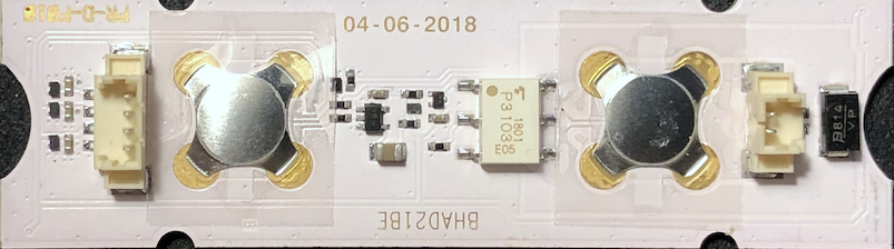

berkinet wrote:... I have the old button, time to open it up and see if there are any electronics inside, or just a switch.
Definitely more than just a switch. The photo below is actually the back side of the board. When the button is pressed, the two onboard-switches are pushed against two matching plastic posts inside the case.

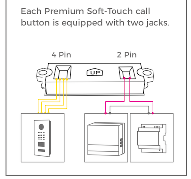

I also have a 2101 (2101V) and the nightly reboot does not send me an alert nor ring the doorbell via the IP Chime. I do not use any of the other contacts, relays, etc.
I also have, with the soft-touch button (the backlight on the original button pad failed so they sent me the soft-touch), and I have no phantom rings. I have the IP chime device.
