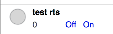

I can add only one of the 3 devices I have but it will not respond
 WebServer                       request to turn off device "test rts" from 127.0.0.1
   RFPlayer Error                  plugin does not define method actionControlSensor
   WebServer                       request to turn on device "test rts" from 127.0.0.1
Skærmbillede 2018-07-29 kl. 16.34.26.png (13.69 KiB) Viewed 4910 times
Re: Somfy/RTS control
Update to https://github.com/FlyingDiver/Indigo-R ... /tag/7.1.2, which should fix that error.
What do you mean "I can add only one of the 3 devices"? What happens when you try to create the others? Are you seeing three devices in the pop-up when you create the device?
