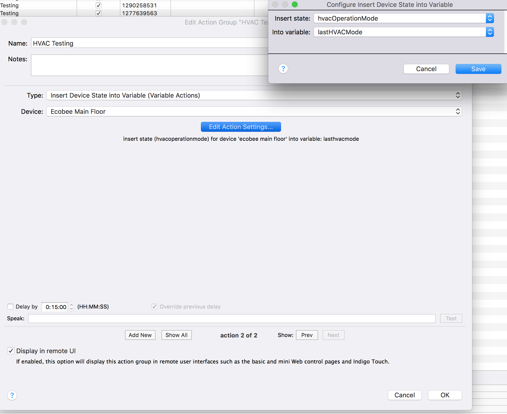

Re: Ecobee plugin continued
Or:
Screen Shot 2018-07-29 at 8.18.13 PM.png (301.28 KiB) Viewed 4403 times

FlyingDiver - exactly what I was looking for. Thanks!
