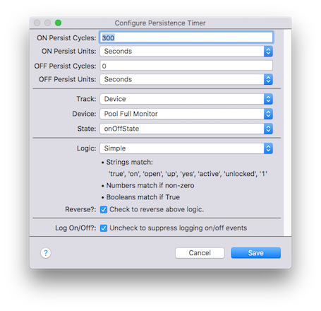

and here are my device settings:

Could you please update to the latest version (0.0.10), turn on debug logging, and post the results?

The plugin believes that your device "Pool Full Monitor" is changing state, and the plugin device is responding correctly to the apparent change (note that newVal in the log is alternating True/False) . Is there anything particularly weird about "Pool Full Monitor"? I don't see how your log results from anything other than Indigo reporting that its onOffState has changed....
1. I have posted another plugin release (v0.0.11) that adds even more debug logging. Please turn on verbose debugging from the plugin configuration and post the results. (You will also probably want to disable the countdown timer if it is enabled to avoid multiple log entries every second).
2. Try temporarily changing the monitored device to something that you can easily toggle manually. Does it behave correctly now?
3. Try temporarily setting both the on and off persist to 1 second. Does it change every second?

It almost looks like "Pool Full State" and "Pool Full Monitor" are tracking each other in a circular fashion. It is passing strange that "Pool Full Monitor" onOffState always appears to go False (reversed in the plugin to newVal:True) within a fraction of a second after "Pool Full State" turns off -- and then the same on the reverse.
I don't imagine this is the case, but I have to ask: "Pool Full Monitor" is the actual physical switch in your pool, right?

kmarkley wrote:... "Pool Full Monitor" is the actual physical switch in your pool, right? .
Yes. That is the physical switch. But wait, it gets weirder. I changed the input of the timed device to monitor a variable, and that worked as expected. Then, I changed it to a Z-Wave light switch, and that also worked as expected. Finally, I switched it back to the original switch and... it worked.!
Maybe there was something in the original device properties (created with plugin v 0.0.9) that caused the problem. Then, when I changed the device today, using 0.0.11, the corruption/error got updated/corrected. Just guessing. In any case, it seems to be working correctly now. Thanks.

If your presence sensor is a single device (including a single virtual device that reflects multiple physical sensors), then a Persistence time will do what you want. The off timer won't start until the tracked device becomes off, and the persistence timer device will turn off when the timer expires.
Activity timers, as described in the first post, are designed primarily for momentary inputs, like a typical motion sensor. It sounds like your presence sensor holds it's on state for a while. I could theoretically start a timer at the last tracked off instead of the last tracked on, but I need to think through the implications of that.
