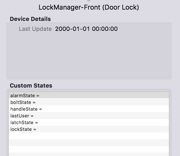

Hi.
I am experiencing the same/similar problem with a new Schlage BE469. It is almost as if Lock Manager doesn't see the lock device, except a few things do work.
The lock is reporting and operating correctly from Indigo client.
Lock Manager reports status changes in the log, but all device states remain blank, e.g.:
Z-Wave Lock Manager             Latch open, Bolt locked, Door open [Node: 4]
Also the Last Update field never changes.
Triggers that work:
  • Manual un/locked
  • Code un/locked
Triggers that FAIL (silently):
  • Indigo un/locked
Actions that work:
  • Get PIN (returns asterisks as expected)
  • Set PIN
Actions that FAIL (with errors):
  • Enable/disable auto relock
  • Set operating mode
Action errors are always:
InvalidParameter: could not find module/node for action
(with different line numbers and method name depending on the action)
Menu Items:
  • Test status response: Z-Wave Lock Manager Debug lockIDs: [4]
  • All others: <no feedback>
Thanks.
Lock Manager device states
That is (was) expected behaviour; the coding for status's of the dummy device weren't added until 1.0.43 released this morning. (They existed because I had to back-port some code from my beta which does use them)
