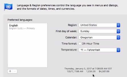

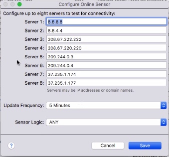

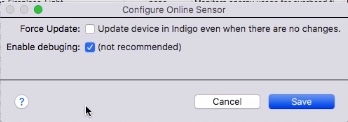

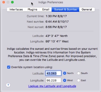

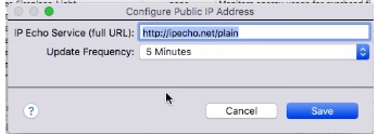

Here are graphics fir the plugin config, the 2 device configs, the Indigo setup and the Mac Server Date/Time config.kmarkley wrote:Hmm. This has something to do with converting datetime values. I won't be able to look into it until this evening, but in the meantime it would be helpful if you posted the configuration for the device and also maybe your date and time localization settings (i.e. how are dates and times displayed on your system).
- Indigo Config.jpg (39.67 KiB) Viewed 18423 times
- Public Address Config.jpg (19.02 KiB) Viewed 18423 times
- Online Sensor Config.jpg (39.68 KiB) Viewed 18423 times
- MacServer DateTime Config.jpg (31.18 KiB) Viewed 18423 times
- Plugin Config.jpg (17.14 KiB) Viewed 18423 times
