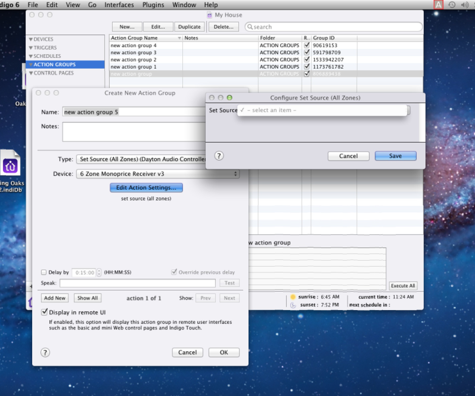

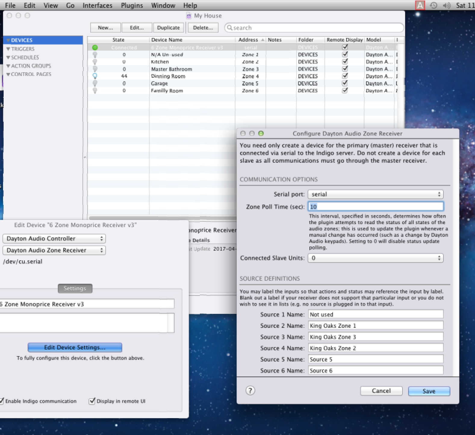

Seems like there might be a bug... I'm using 6 zone monoprice receiver and can't seem to set "Set Source (all Zones)" action group. The menu is completely blank- while I'm able to set individual source select action groups.
Any idea why this might be happening? Everything else seems to work!
Thanks for sharing this great plug-in!

Sorry for the delay, was out of town for the weekend. I think that I found the issue -- I'll see if I can get a new version up tonight or tomorrow and will post to let you know.
