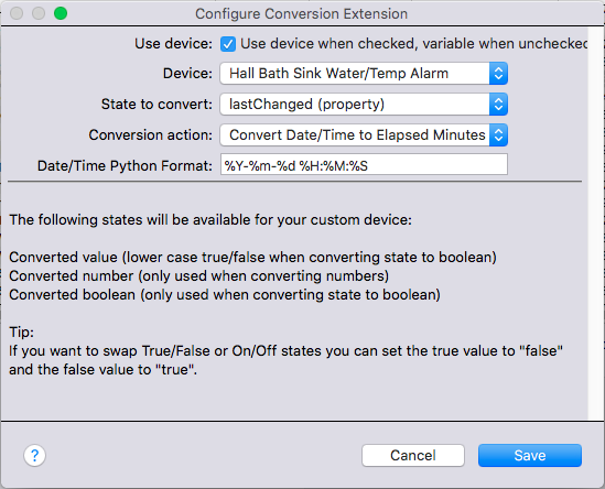

I use the conversion extension (version 1.53) as part of trigger to monitor for device updates so I can be alerted if one of our sensors failed to check in within X hours.
This has been working great until a couple of Indigo updates ago (don't remember which). The initial error was that the EPS devices all stopped functioning and the log filled with red complaints. At the time I downloaded a fresh copy and reinstalled the plugin.
Today while doing other work noticed the following error repeated every 10 seconds:
Here is the settings page for one of the devices. They are all the same except pointing at different sensors:
All the devices still work, there is just the error in the logs that keeps repeating.
I have tried reloading the plugin from its menu and reloading all libraries and attachments. No joy.
BTW, the download button Here http://forums.indigodomo.com/viewtopic. ... 97&t=16233 refers to a page that links back to the same page with the download link rather that an actual download.
Thanks for writing this.
EPS - Device Extensions Error Error in plugin execution runConcurrentThread:
File "plugin.py", line 590, in runConcurrentThread
File "plugin.py", line 466, in forceUpdate
KeyError: 'key id 384019400 not found in database'
EPS - Device Extensions Error plugin runConcurrentThread function returned or failed (will attempt again in 10 seconds)All the devices still work, there is just the error in the logs that keeps repeating.

Sorry, I didn't notice this outstanding. That KeyError means that the device ID referenced, 384019400 isn't part of Indigo any longer - it may have been removed or replaced. That being said you may want to upgrade to the latest that I just published since it was mostly rewritten and better traps errors such as those.CraftGeek wrote:Traceback (most recent call last):
