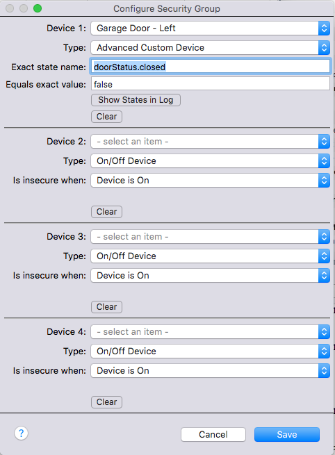

I agree, the first one should work. The second won't, because there are states other than "Open" that are insecure. "Stopped" means the door is stopped, neither open nor closed, for example.

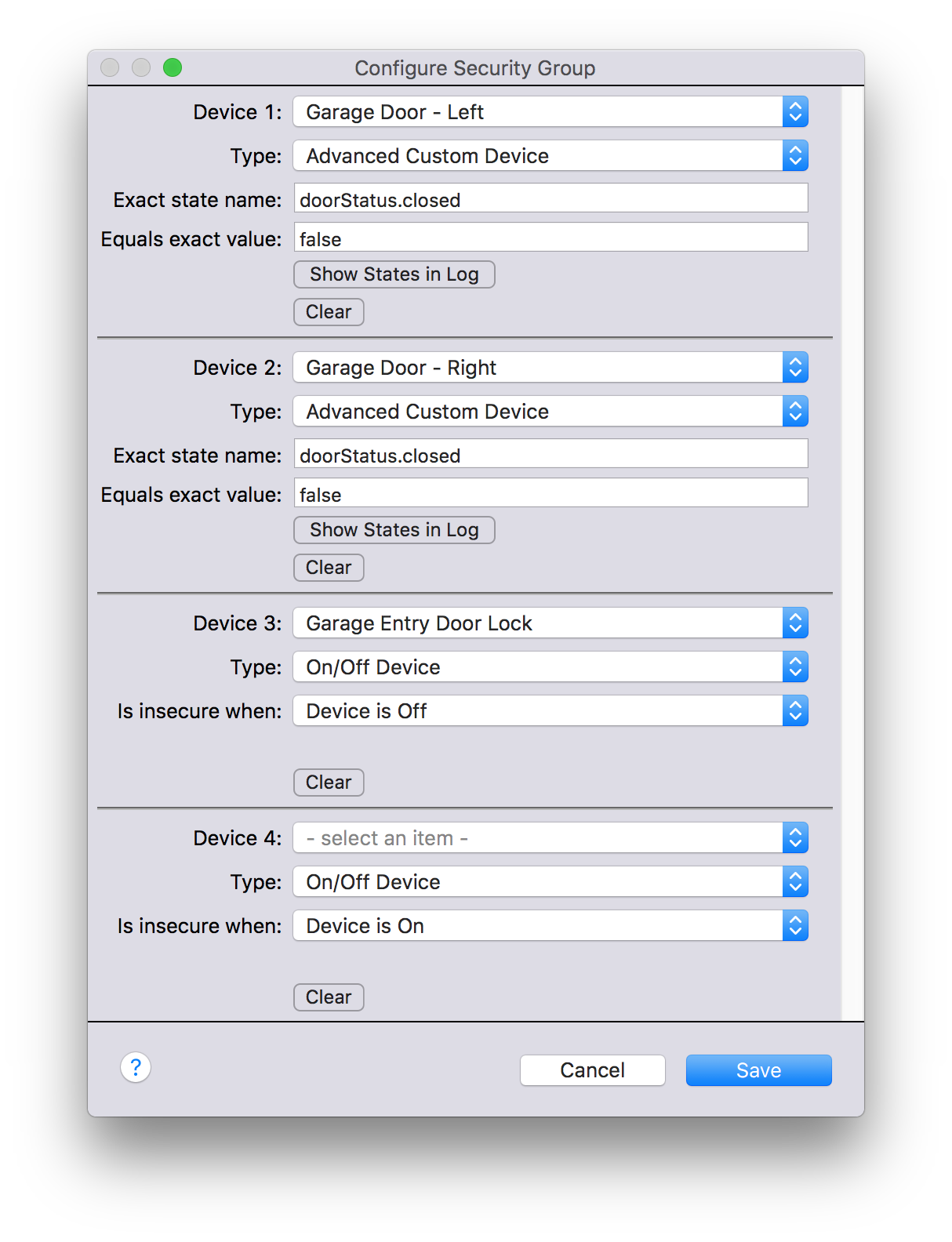

This is what I have for this group. I've tested the door lock alone, and it works.
- Screen Shot 2016-06-18 at 11.56.25 AM 6-18.png (317.1 KiB) Viewed 5658 times

Re: Security Manager Plugin
Ok, I tested it and everything worked for me, I wonder if you have a different state backwards - or maybe my test is flawed, but I did this:
Created a device to match yours:
With an action to toggle the doorClosed.closed state:
Then I created that device in Indigo and linked a new security module to it:
I created a button on my control page to run the toggle action. When I toggle it on (true):
And when I toggle it off (false):
Does that seem like a legit test?

Another thought, try setting up the way you think it should work and then reload the plugin, perhaps the states aren't updating properly when you first create the device. This is one of the things I corrected in later libraries that I need to apply to this plugin just to be safe.

I think I did that, but I'll try again to be sure.Another thought, try setting up the way you think it should work and then reload the plugin, perhaps the states aren't updating properly when you first create the device. This is one of the things I corrected in later libraries that I need to apply to this plugin just to be safe.

It's also quite possible the MyQ plugin isn't setting states properly. All I see in the states inspector panel is "doorState=Closed", which SHOULD mean that doorState.closed=true. According to how I was told enumerated states work.
I'm considering switching the device type to relay rather than custom and just adding doorState as an additional state. More code logic needed to set the onOffState properly, but the bonus would be that there would be On/Off (Open/Close) buttons on the device panel.

Ok, I just did that and everything still works hunky dorey.

Yeah, late this afternoon when I was working on the MyQ plugin. Case mismatch. At least, that's what I think it was. Of course, now it's a relay device and I can just use the On/Off state instead.Colorado4Wheeler wrote:FD, did you figure this out?
