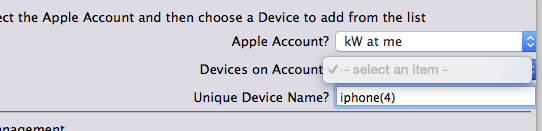

iFindstuff Alpha Testing Topic
can not get it to find my devices.
have added my account thats green.
then add iDevice I don't get any devices I can select from.
I get an email from apple :Your Apple ID (xxx) was used to sign in to iCloud via a web browser.
in the log I get
iFindStuff cannot be located
what am I doing wrong ?
in the log I get

Re: iFindstuff Alpha Testing Topic
w 0.4.20 still the same result
1. delete all folders and devices
2. stopped indigo server
3. deleted prefs file and plugin
4. start server
5. download plugin and install
6. add account info, got email from apple : logged in fro browser ..
7. account info turns green
8. add iDevice : Devices on Account is grey = no devices available.
4. start server
