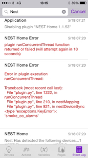

Been [=0]ImageUploadedByTapatalk1431951478.358815.jpg[/attachment
Been having errors since last update, any ideas?
Chameleon
Posts: 611
Re: NEST Beta Forum - Feedback and support requests
Post by Chameleon »
Hi
I think that the problem was that my code wasn't picking up the devices properly. I'm assuming that you don't have any protects is that right?
Anyway it does highlight a possibility in the code that it would miss this error. To check this out can you download and install this version (1.1.54) as a test. It should avoid the error. I've tested it on my test bed system but some reassurance from another test before a general release would be useful.
Please download the trial from: https://www.dropbox.com/s/qqdg6l85respo ... s.zip?dl=0
If that doesn't work then we'll have to investigate further. Can you let me know your setup... i.e. number of devices, types and generation (1 or 2).
To all other users - This is not an official release and you install it at your own risk. That said it won't do that much damage and you can always downgrade again! :D
Mike

Ksullivan
Posts: 83
Joined: Sat Feb 22, 2014 5:02 pm
Post by Ksullivan »
Hi Mike
I'm running 1 nest and no protects and have just loaded the amended plugin and all seems ok ,
I'll keep you posted
Thank you
Keith
Chameleon
Posts: 611
Post by Chameleon »
thanks Keith - Keep me posted. I'll upload the new version now for everyone in your situation :)
Thanks for testing
Mike
