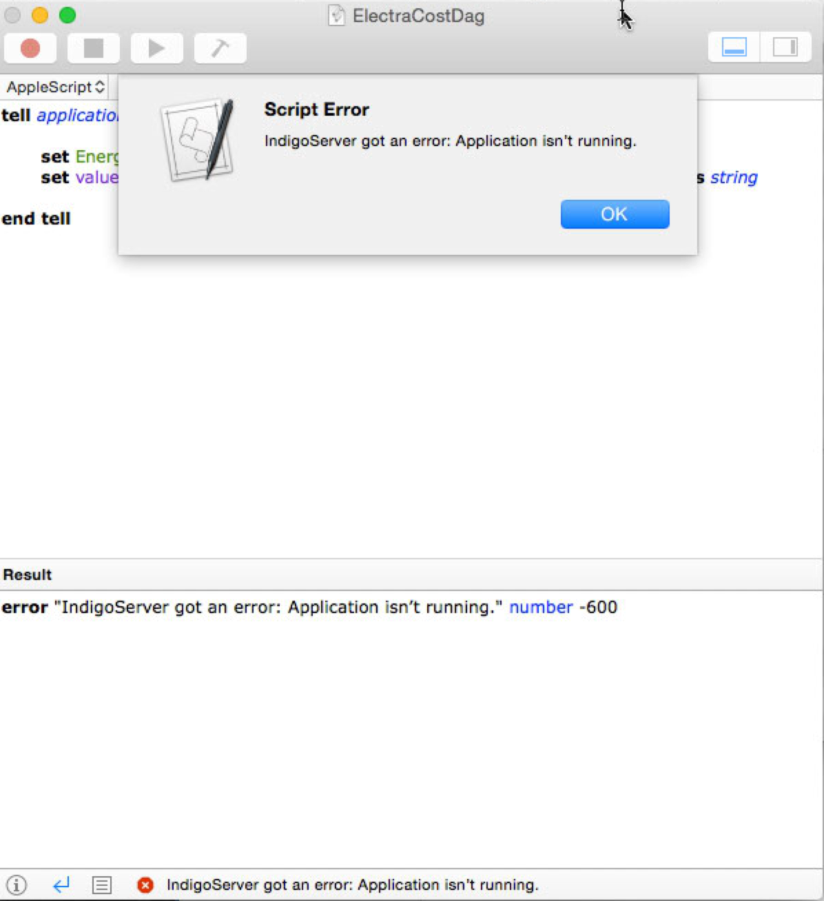

Re: AppleScript "Application isn't running" (-600) Errors
Could anyone tell me why this problem, ONLY exist with the Indigo Server app.
I installed a brand new Mac mini, with fresh new Yosemite 10.10.5. and a new download of the Indigo installer and copied my old Indigo database.
Everything is working fine except the
external Indigo AppleScripts.
Every other AppleScript works perfectly; SecuritySpy, iMessage scripts, all working fine.
Except the Scripts which make a "call" to the Indigo Server app. It's running (I see it 1 x in the Activity Monitor) but all the ~20 scripts are not working anymore
So, with Maverick indeed a re-install of Indigo would help. But even this "solution" don't work anymore.
This is really an Indigo problem.
Kind regards,
John
Kind regards,
John
- Schermafbeelding 2015-11-18 om 21.32.48.png (409.86 KiB) Viewed 15286 times

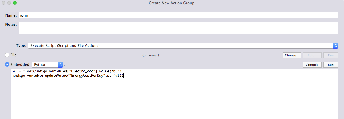

John,
replace applescript:with python code :
put the above code into and action in an action group or action in a schedule:
But this will only work internally = inside indigo.
doing this from the outside use either restful urls or use the plugin SATI from applescript.
tell application "IndigoServer-x"
set Energy_dagconsumed to (value of variable "Electra_dag" as number)
set value of variable "EnergyCostPerDay" to (Energy_dagconsumed * 0.23) as string
end tellCode: Select all
v1 = float(indigo.variables["Electra_dag"].value)*0.23
indigo.variable.updateValue("EnergyCostPerDay",str(v1))doing this from the outside use either restful urls or use the plugin SATI from applescript.
